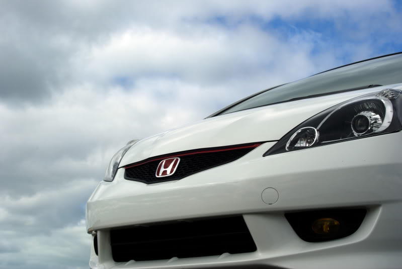

Well these are oem headlights with the retrofit kit from the retrofit source. Not sure if u think I got the headlights aftermarket or not or u are asking where did I get the retrofit projector kit from lol but yea the retrofit source. And the k you for ur kind words my friend

Best mod I've ever done. You won't regret it. I went inexpensive and just did it the easy way. Morimoto mini's w gatlin gun 2 shrouds and I did the custom paintwork.
