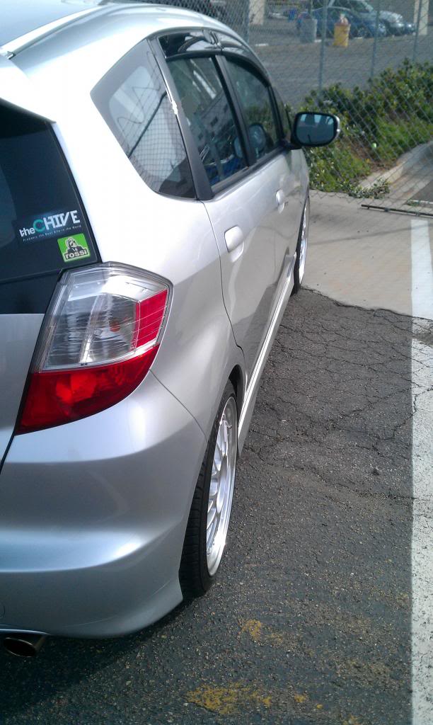

I am running 17x7.5 +40 (roughly = 17x7 +35) with 205/40 tires on Tein springs. I have pulled the front fenders a bit (but not rolled), and trimmed out a fair amount of the fender liner - the rest self clearanced. The front is very flush as I am at stock camber specs for max tire life. The rear rubbed just a hair when I had the car loaded down for vacation and went through g-outs. A tiny bit of roll in the rear would fix it.
If you are planning on running 205/45 tires, then you will need to pull and roll the front as well as trim the plastic liner a touch. Rear maybe a tiny roll.
Here is how it sits:
