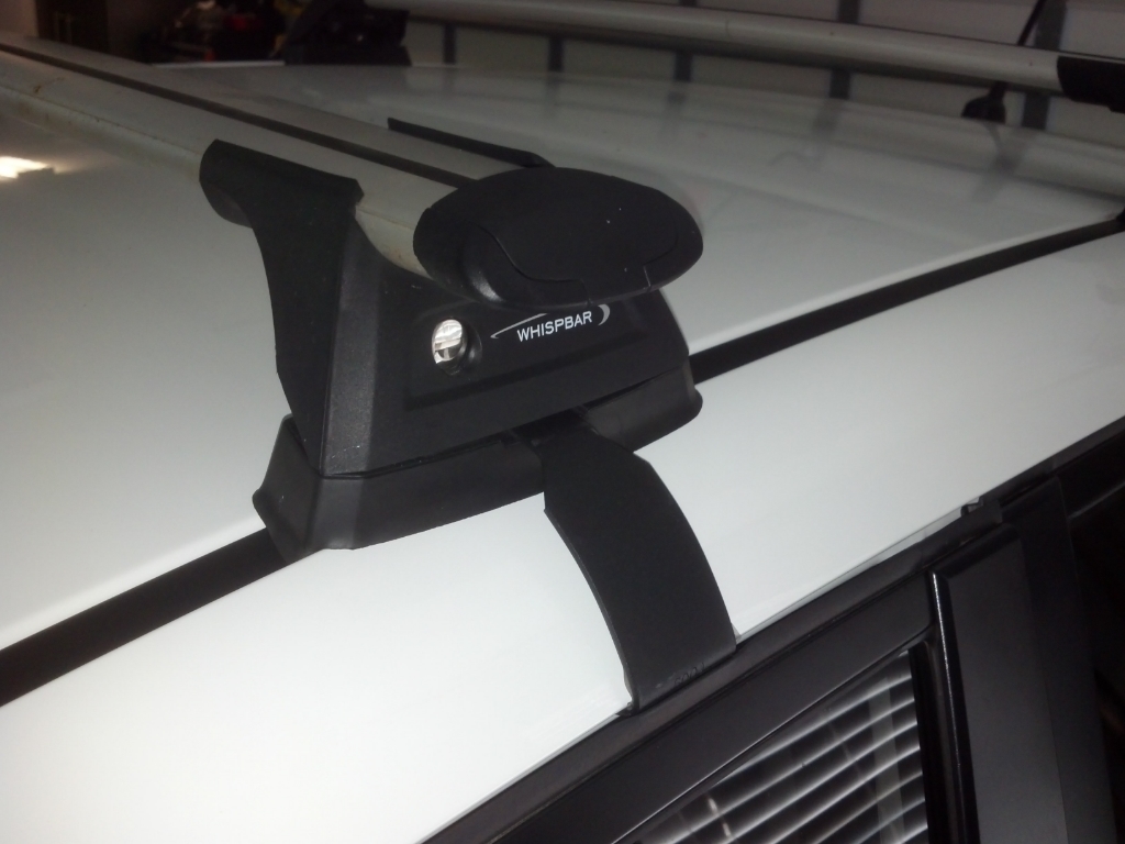

LOL wow a lot of doom and gloom here. The Whispbar recall above does not apply to the Honda Fit. Before spreading fear and doubt read the recall first. The Honda Fit fit kit is K446 and is not included in the recall. Even if it was they would just replace the fit kit with one that works properly.
Here is the link to the recall showing the fit kits included in the recall:
http://www.whispbar.com/download/Con...fit_kits_b.pdf
I pulled my front bar off today to make sure there was no damage to the car and there wasn't any. I have my bars loaded to the max weight specified most of the time. Our bikes are the heavy cruiser bikes and weigh a ton. Both bikes and the bike racks weigh 105lbs. I think the max weight for these bars on the Fit is 110lbs. Our last trip was 2200 miles on northern roads. Other than significant bug deaths there was no damage at all to the car.
There not perfect. They are open in the rear and you can see the lock mechanism. I think that is pretty cheesy. These are not cheap you would think they would have a plastic cover like the Thules.
But they do what they are advertised to do. There is absolutely no wind noise you can not hear them at all even with the windows down. And no damage to the car at all after several months of daily use.
I have to say the metal on the Fit is extremely thin and dents easily. I dented the top edge of the car simply by dropping an empty plastic storage container on it. So if this kit was going to dent the car in any way I am pretty sure it would have already done so especially after the 2200 mile trip to Canada.
Good luck with the Kayaks. Can someone point me to the thread that discusses tying the kayaks down to the front? I can't find it any where.
