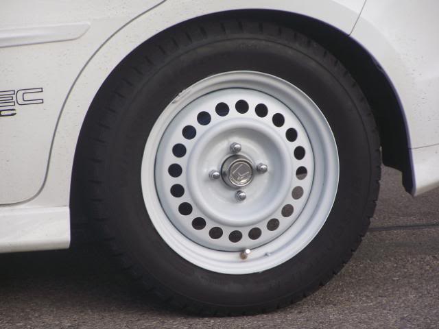

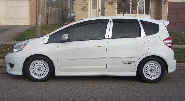

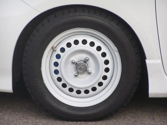

I run 185/65R15 snows and I am lowered on Swifts.
I suspect your wheel offset is OEM 53 or 55 mm and naturally a half-inch larger diameter tire will fit. !85/65x15 is a good choice for snow tires too.. OTOH that doesn't look lowered by 1.5" either. But even so with OEM offset should work well for 185/65x15 tires.
