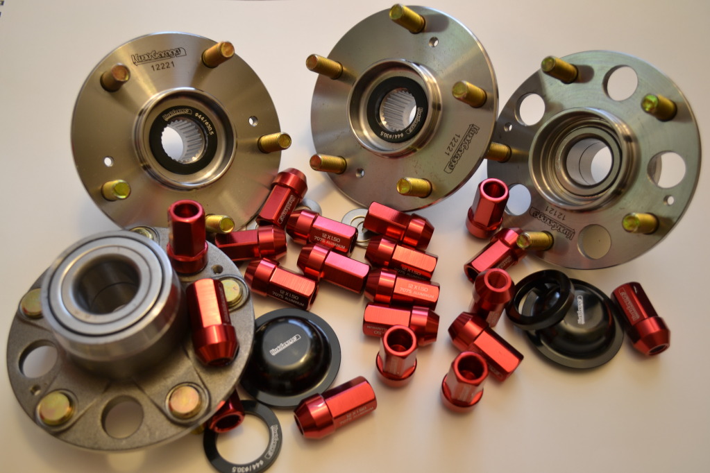

Originally Posted by KJR50
Looks like re-drilled/re-assembled with original Fit parts, look at the original lug holes in the brake disc. OP, any noticeable vibration issues?
The Disk Brake Rotor and Rear Drum Brake Cover (USDM) might be drilled without problem.
but this part right here:
The actual Hub were the wheel stud is, got to be from a new / different part.
Because there is no way you can re drilled the original 4x100 holes to install the new 5 wheel stud.
Kuo's Garage had made a conversion kit,
but I always think that a CR-Z 5 hub would bolt on to our Fit (have not compare the part side by side though),...
so your mechanic must either found another Honda with 5 stud hub that fit to our Honda Fit or he must machine/modify it to fit.
The question is,
Which car model did that 5 stud hub came from?
here is the Kuo's garage hub for reference so you can see there is no way to redrill that part,
because the stud had to be TIGHT, and re-drilling will have at least 2 holes overlap and will not allow the
stud to be TIGHT fit:
