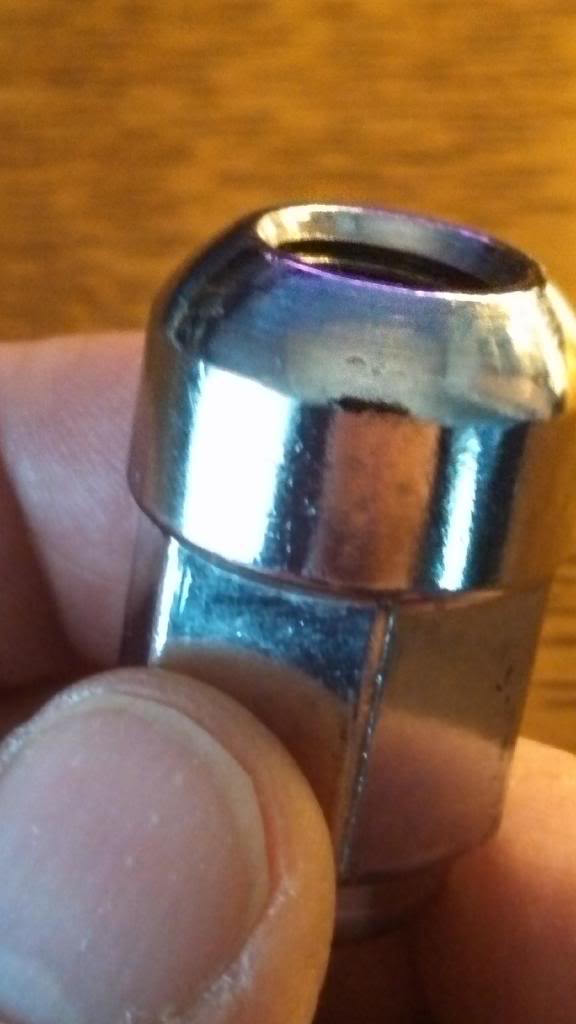

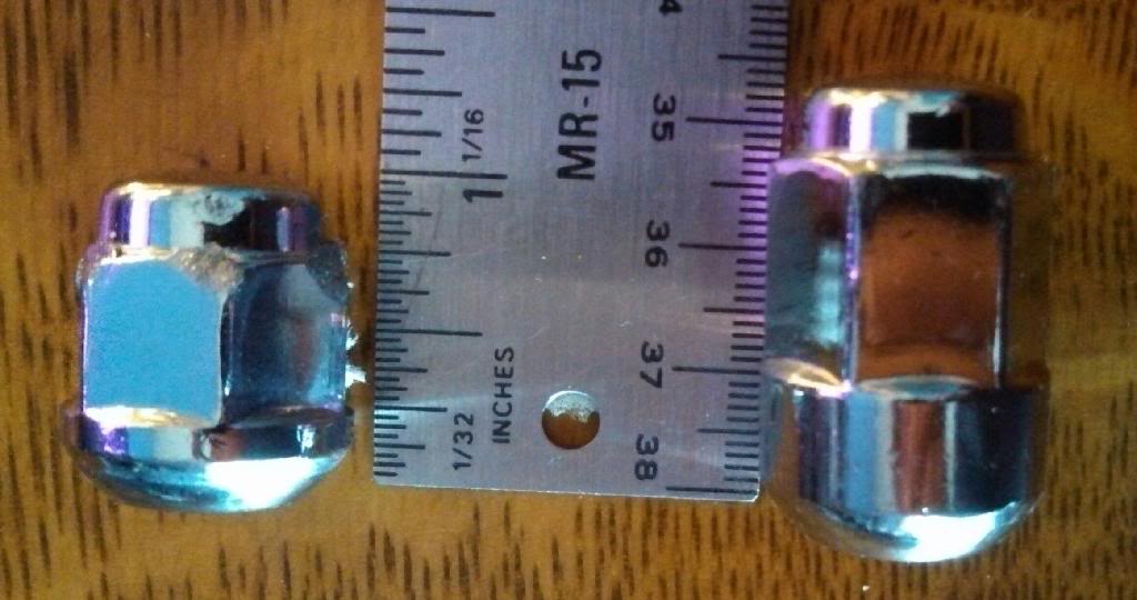

A couple of other things to be aware of, in addition to the 12mm x 1.50 thread; for stock Sport wheels, the base of the lug nuts should have a ball/radius seat, not the acorn/tapered seat. Also the lug nuts come in different overall lengths. For example, 1.4" long will protrude too far on the earlier, (before 2012) Sport wheels. I know this because I have both sets of wheels and you can't interchange the lugs.
Left hand image: 1" long from 2007-2011. Right hand image: 1.4" Long from 2012+. Notice the ball/radius at the base.

Closeup of end showing ball/radius seat
