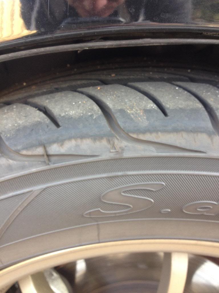

Most tires also have a sidewall indicator you can use if you don't happen to have chalk. Not sure if the stock tires have them, but most do?
This is from my run last night pushing a Miata LOL
You are right, but if you roll the tire over too far, when you add air to compensate you will need chalk to reflect the new tire roll. That triangle is the max roll that the tire should see. What were you running for psi?

That's true, but at least you'll know after your first run if you're way off base and can add air, I mean if you don't have chalk anyway. You could also scrub it off a little bit after a run.
For that pic I am running 36psi on 205/55/15 S.drive on 6.5" wheels, canyon run, fairly technical, several 2nd gear turns at grip limit.
