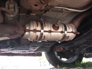

Do you still have the piece? You can either get it welded back on or...
get 2 hose clamps from your local hardware store and strap it back on XD
That pic is from a gd3 but I would assume this would work with almost any shield.
