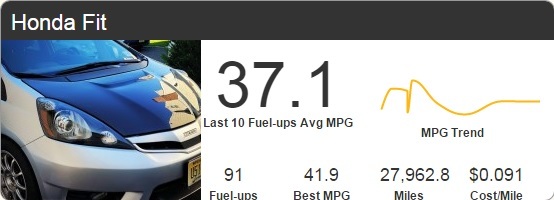

my Scangauge, onboard MPG meter and calculations are spot on. Strange though how my Scangauge never goes 9999 anymore. My average keeps going up this summer maybe because it has been very mild. My last 10 fill up average is nice!
