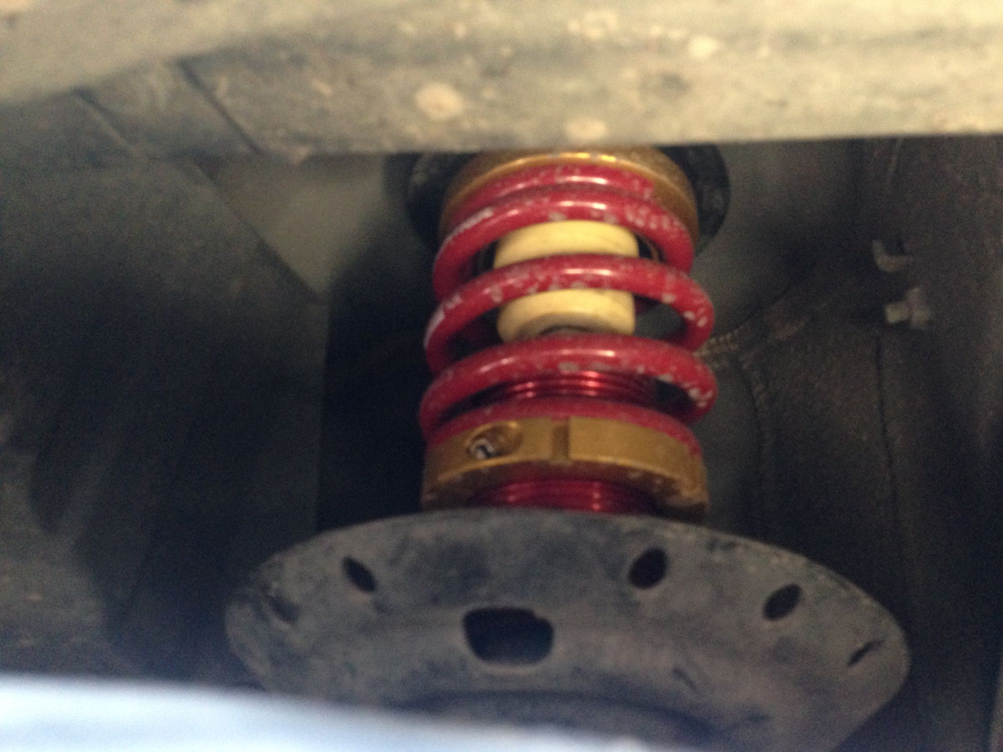

pic as promised for discussion.
now lets discuss:
this is wrong because the mud sleeve is smashed against the spring, and the oem spring top seat should be removed (for ground controls). i removed both the mud sleeve and spring top seat and installed it like that. thanks to Kelan (Hootie) for pointing me to look at his tokico/ground controls to help me get mine right. mine basically looked like Hooties' when i reinstalled them in my car.

Old Oct 14, 2015 | 08:53 PM
Regdog77's Avatar
Joined: Apr 2013
Posts: 205
From: Cali
That looks way off. What did the install instructions show. Hotties looked good except for the bump stop was upside down.
Old Oct 14, 2015 | 11:02 PM
space egg's Avatar
Joined: Mar 2015
Posts: 254
From: West Yorkshire UK
Originally Posted by Regdog77
That looks way off. What did the install instructions show. Hooties looked good except for the bump stop was upside down.
actually you can't see Hooties bump stops lol. i think he removed them entirely!?
lol, he's a Honda Tech so Im certain he knows what he's doing. but yeah i don't even see the bumpstops
i cut off 1.5" from my bumpstops up front. they are hidden behind the mudguard in the pic.
tomorrow I'll go photo my fronts as installed where the bumpstops can be clearly seen, and post back
Old Oct 16, 2015 | 03:32 AM
Hootie's Avatar
Posts: 5,093
From: South of Heaven
Nope, I cut it to the very last rib of the bump stop... So I literally have about a 1 inch bump stop. If you take a gander at the upper strut in the box, you'll see my stubby bump stop in the center of the spring.

Front strut pic.
So it turns out that I only have about 1/2" of travel before I'm on the bump stop.
i hadn't noticed hitting the bump stops but i must be hitting them often. This would help to explain my bumpy ass ride. I may need to cut more of the bumpstop off. I haven't cut any of the rear bumpstops at all.
Well I autocross tomorrow, so that will tell me a lot about what is going on. i have a feeling I'm already deep into the territory of needing the koni streets or yellows

Wow. I would define to cut one more rib off the bump stop. Any noise or movement coming from the sleeve at full extension
Old Oct 17, 2015 | 08:25 PM
Hootie's Avatar
Posts: 5,093
Yeah... I definitely would have cut those a third to a half off at LEAST on the bump stops.

this week i cut off 3/4" of front bumpstop,
and about 2.5" of rear bumpstop,
and now my ride is a hell of a lot smoother. i can't believe i was basically running around town sitting on my bumpstops in both the front and the back ---for so long!
