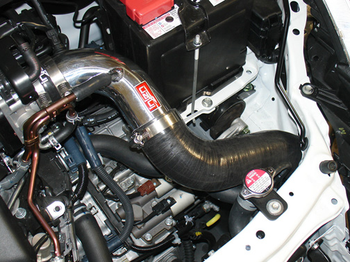

The gains are negligible between the HPS and PRM intakes. The both suck in hot air. The advantage of a short ram intake is that it is easily accessible for maintenance. That's really it.
If there are gains to be made it is with a a CAI (like Injens or other equivalent). The CAI on this car is inconvenient to clean every ~15k miles; because it requires removing the bumper. That being said, the air filter doesn't need to be cleaned very often and it is not difficult to remove and install the GE8 bumper.
For reference I have the Injen CAI.
What are you trying to achieve? (race car, trackday, DD...)
Attached Thumbnails GE8: HPS v. PRM-80-blob_b2067aa631158e144deb5d5d46c52004eec0f2b4.png
