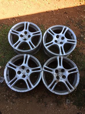

I came across these wheels for sale and they look pretty good with some TLC but, just wondering if they would fit on a 2010 FIT?

Yes, should be same bolt pattern.

Double-check the center bore!
Miata center bore is 54.1 mm. I believe the fit is 56mm so the miata wheels won't clear your hub unless they are aftermarket.
Someone please correct me if I'm wrong!!
