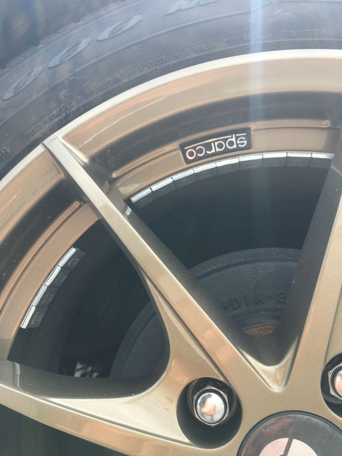

Hi everyone! Does anyone know those piece steel is for?
I bought a set of four wheels, one of them had some steel on it. Don't know what is that for.

Those are wheel balance weights.

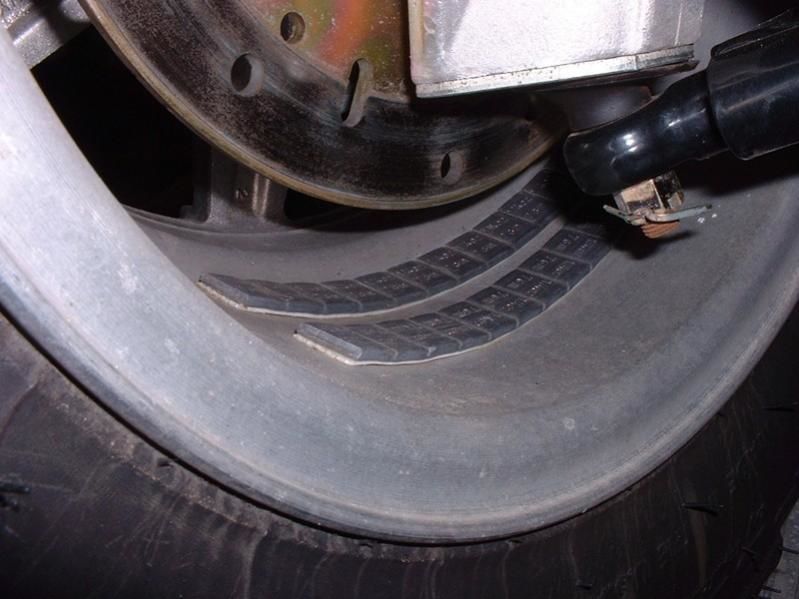

And its not just the wheels that you balance for. You also balance for the tire. If you look closely at a new tire, there will be a mark on the sidewall that shows the heaviest part of the tire. The tire should always be mounted with that mark on the opposite side of the wheel from the valve stem.
As for the visibility question, if the wheels were balanced off the car instead of while mounted, and if possible, the weights will often be put on the backside of the wheel. See the pic.

some shops have machines that do a static balance they will put all the weights on the back side typically for best looks.
Dynamic wheel balancing usually puts weights in both the front and back side of the rim to reduce shimmy for the wheel/tire combination being out of balance in a axial as well as radial direction. (Thats how that sparco wheel was done I'd bet. )
