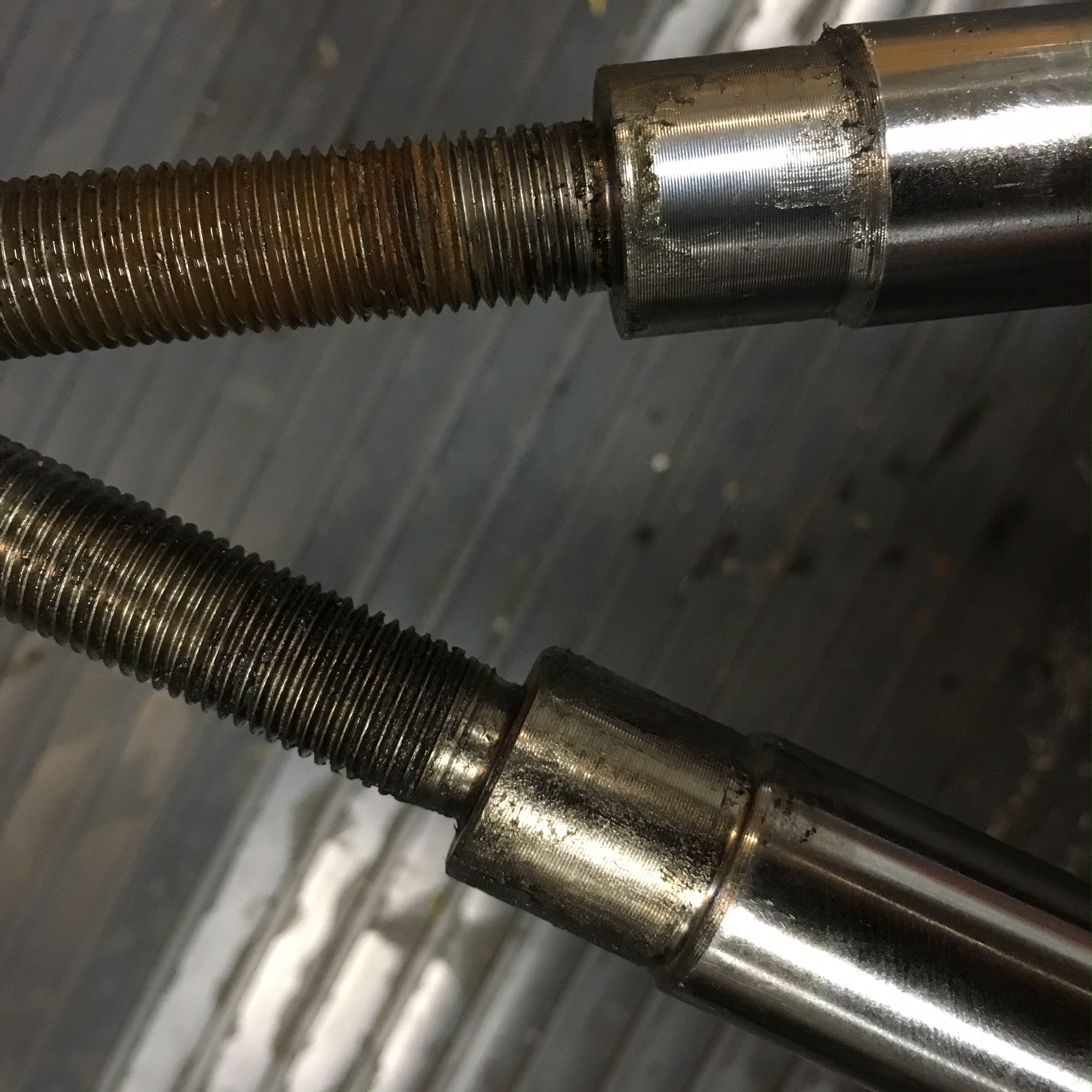

If you are a car guy and are going to do the fronts yourself, you will need to get the MAPP gas or torch out to heat up the lock-tight to pull the front struts and all you will need is a new front mushroom bearing for the upper struts. I bought a KYB kit but did not use the new upper rubber bumper because it was not squished down and would of added another 1/4 height that I did not want, plus the upper bearing was a tighter FIT in the older one. The new ones would squish down with time. You will have to add 2 grade 8 custom washers that YOU will have to fabricate to fit over the threaded top of strut. Koni's machining did not thread all the way down to the piston rod and then they tapered down to give it too much slop for the upper bearing to slip back and forth. This fixes their design screw-up and I have been in contact with Koni about this. You will notice a lot of slop in the bearing area where the strut was stepped down, this by design for the unrefined design by Honda to deal with turning of the upper strut off axis going lock to lock.
