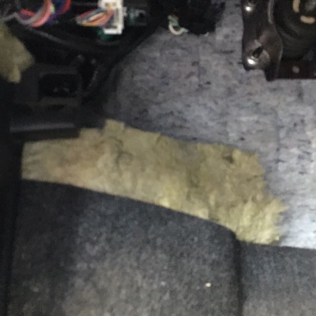

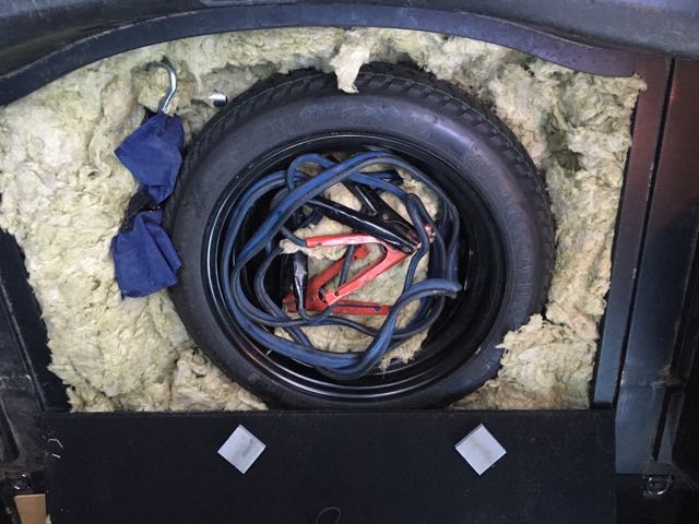

So when I decided I was going to keep my 2009 Fit and not get a new 2016, I was going to do some stuff to it at it's now 55,000 mile mark. I installed the orange Koni's to my liking, and then I wanted to quiet the cabin noise down a bit. So Project Roxul was started.
I am not fully done with this project and I have had good results, so I am posting what I have done. I wish I would have driven on a couple roads and then did the fill job to get a proper imprint of change to compare. I did this over a 2 week period. 1st the back then a week or two later the front. I still want to pull the back hatch door plastic to add some there.

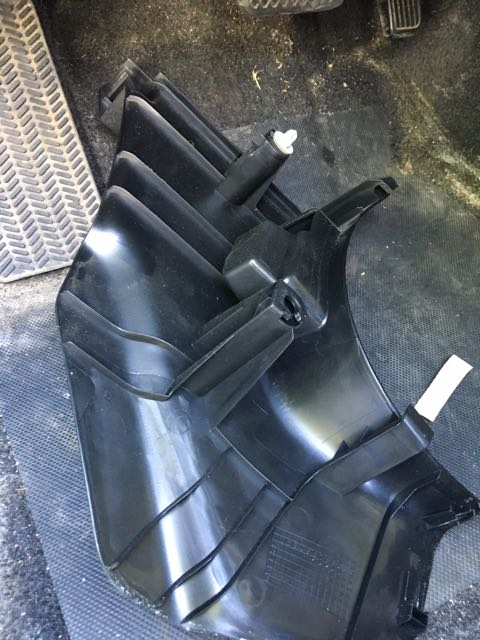

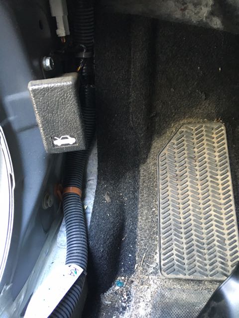

Doing this "I think" it reduced the so called "pillar" wind noise that now seems to actually be made by front wheel well wind noise that was reduce here. I also pulled up and filled the front door kick board area by the front seats as it was part of the hood opening piece that is in the photo.

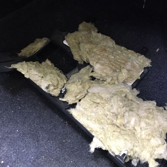

I keep my rear seats down most of the time so I use to get a lot of noise from the back area, Not any more!! I fully lined the spare tire tub with 1 inch of separated/pulled apart Roxul, then screwed down the tire and added to open areas with more Roxul. I also used a very very light coating of hairspray to the final laid in pieces to reduce particulate floating. I know added fire issue but a used a torch and no real difference in flammability. Very light spray is the keyword here.

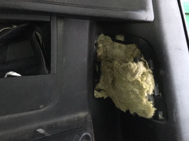

The picture with the hog pog of pieced together bits was the under the dash panel on the driver side and the same was done with the passenger side. I also added a 1/2 to 3/4 thick layer of Roxul the the front wheel wheel area that already had some factory soundproofing as seen in photos. For the rear wheel well covers I did not completely pull them out, I pulled the backside of them out as in opening a clam and added 1 inch thick Roxul separated sheets/chunks. Added a bunch to block noise coming from the inset storage area on the back passenger wheel well. Also rear light s were covered as in photo.

pics 1&2 self explanatory, pic 3 passenger rear tail light. 4&5 self explanatory, pic 6 driver side side kick plate off and is in pic 6&7. Also in pic 6 look at top of pic see the gray factory soundproofing, now look at pic 9 that is where I added Roxul to the place you looked at the top of pic 6.

You bet, I have my back seats down most of the time and I would get a ton of road noise, now it reduced by 50% to 60% plus. And I have not done anything to my doors yet. Remember I added Roxul to the under dash panels that keeps noise coming down from the upper firewall and engine. I also added a big chunk behind the center console . I may even go to that extreme too...pulling and soundproofing the center console between the seats. So total est weight added could be in the 20 lbs area, WORST case scenario or 3 gallons of gas added added weight.

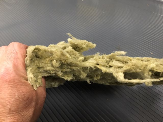

I did them inside the door panels with some double sided tape. Look at my pictures on how I pulled it apart to change the thickness I wanted. Also I pulled 1/2 way out the rear wheel well panels and put a layer all the way around the wheel tube, I did not just stuff the the insulation in the hole as it appears in the photo.
