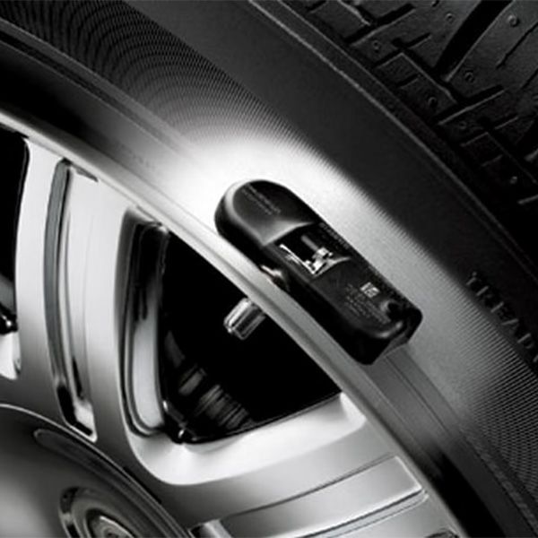

The sensor body is attached to the stem, and resides inside the tire area. Not a simple DIY if you don't have shop equipment.
EDIT: IMO there is considerable expense in having someone do this work on 8 tires each season. And if threads get seized, sensor can break.
Attached Thumbnails Snow tires, new wheels, and tire pressure sensors. Some questions-80-tire_pressure_monitoring_system_sensor_2_9f6d975ee71364d0ba735038aa223d3dca8bbf6d.jpg
