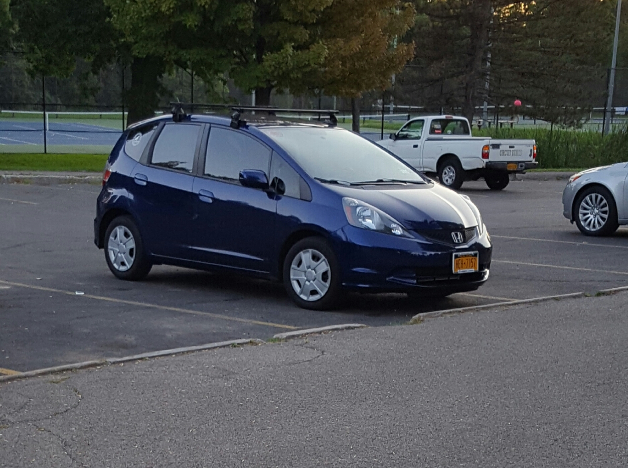

I bought my 2013 Fit this past January, and spent the rest of the winter washing it often to keep salt down.. but now that we're nearing winter #2 I'm looking for ways to keep my Fit in prime condition for as long as possible.
Anyone have rust issues with their Fit? If so how long did it take? Any must haves for winter maintenance? Looking to install some splash guards in the next couple of weeks.

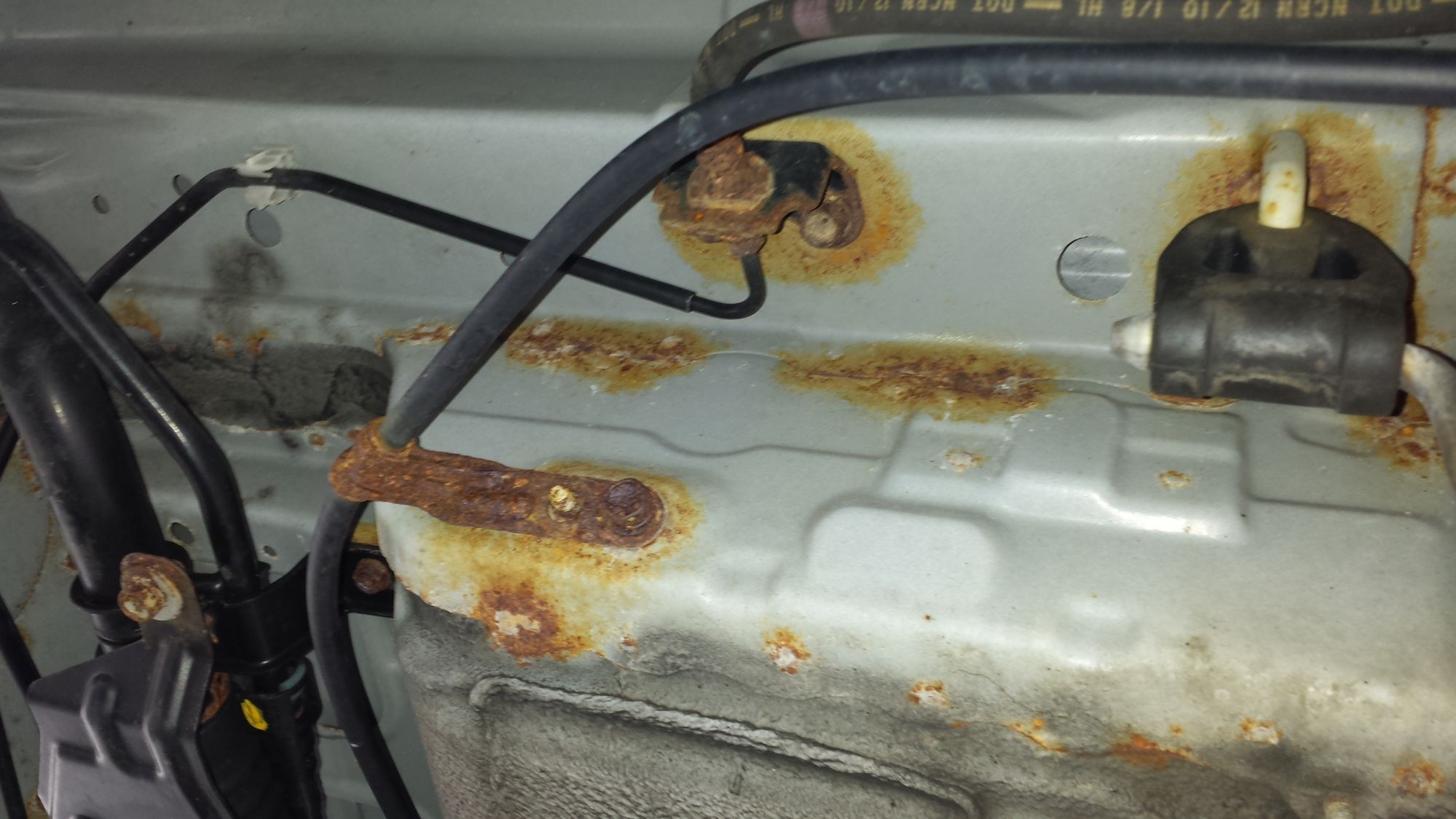

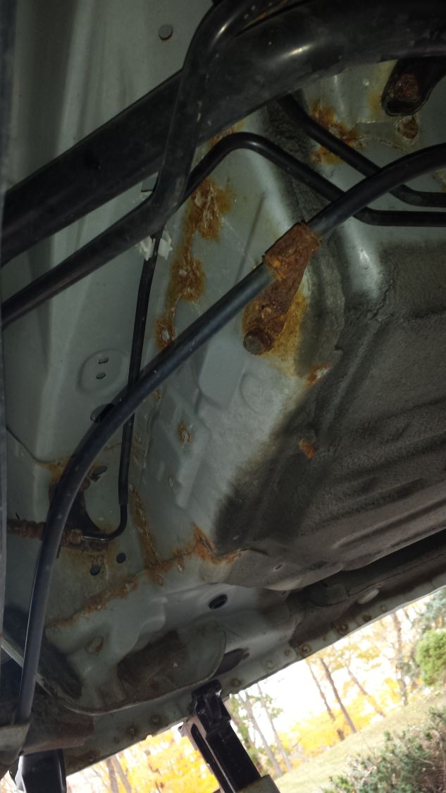

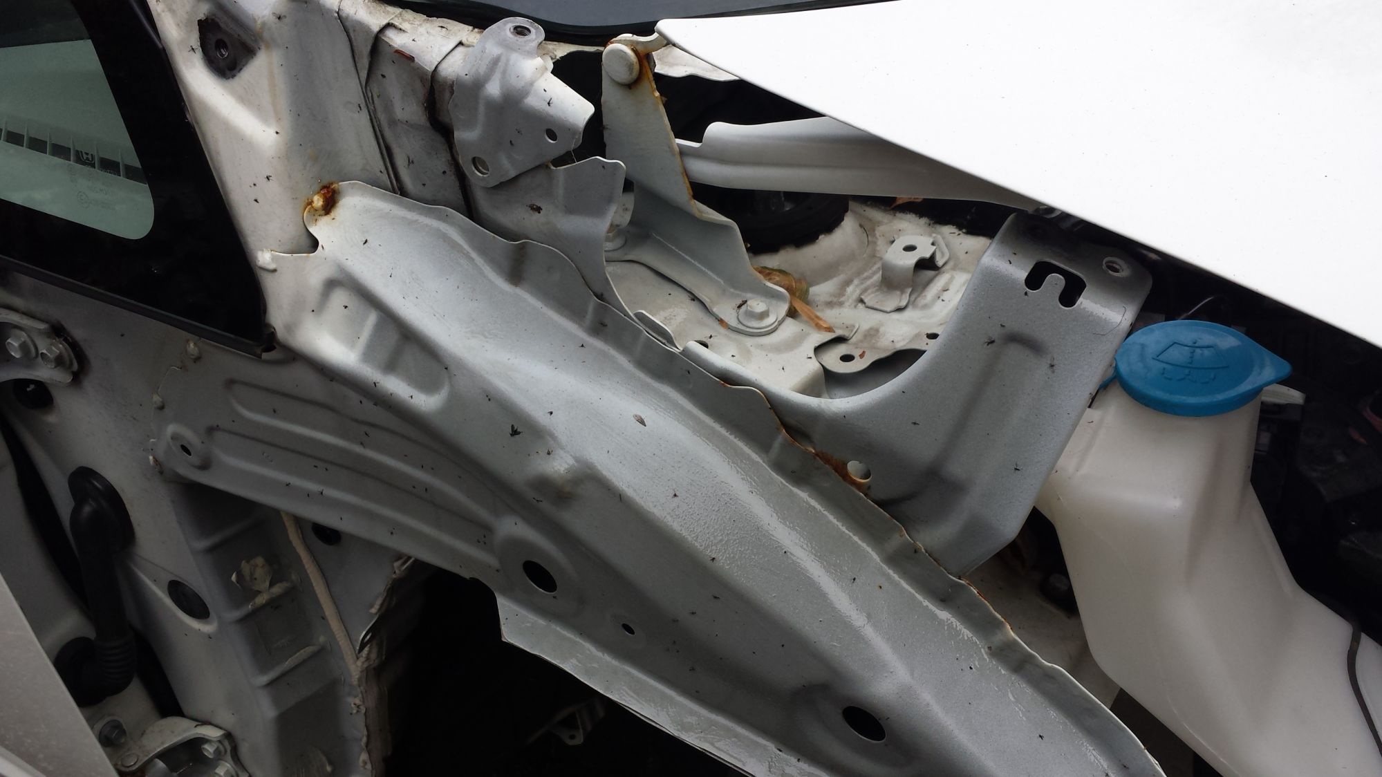

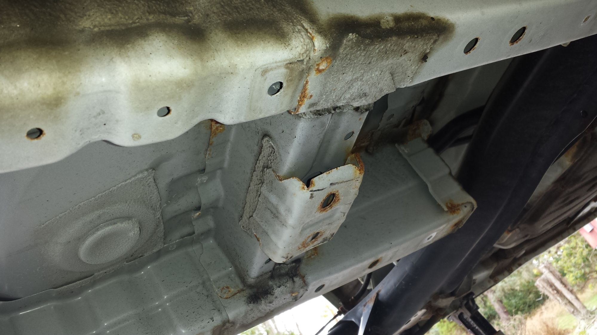

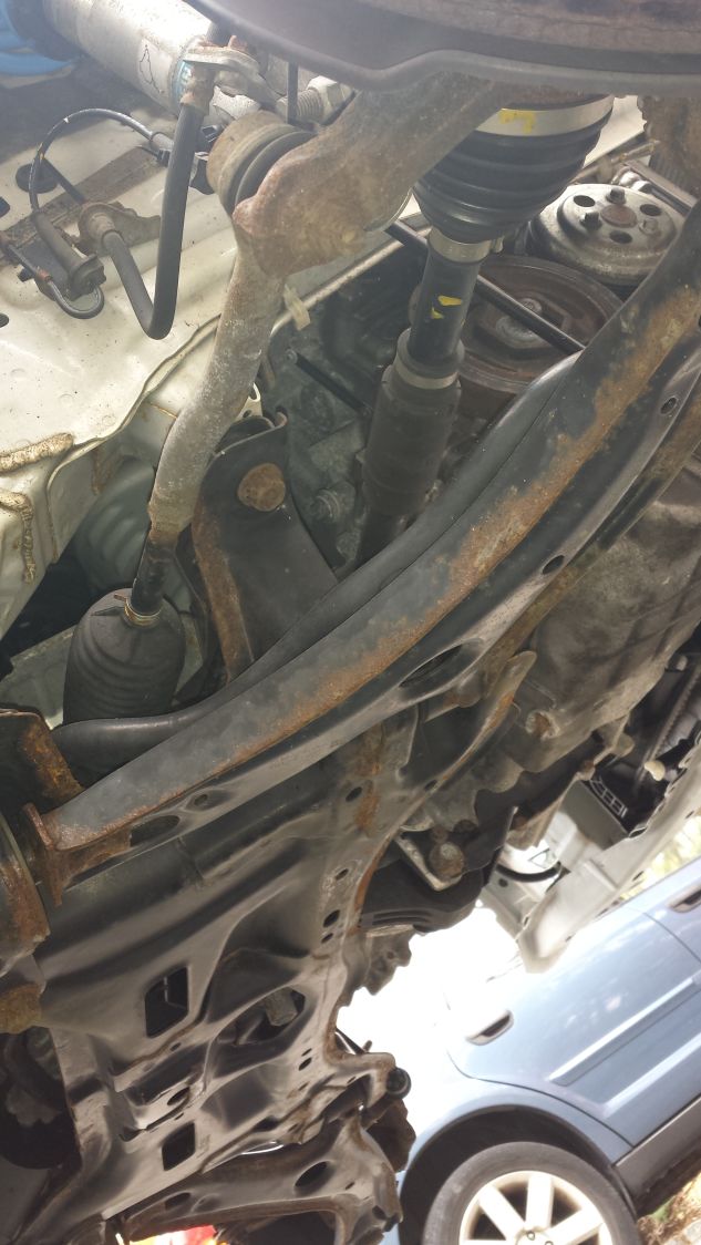

All the little brackets and welds on mine are rusting underneith. It is a 2011. We get a lot of salt here and hover just around freezing, so it warms up to above freezing during the day, and below at night.

My 09 looked about dat after 7 yrs barely washed. I didn't care bought a 16
If u put some oil on the brackets and spray black engine enamel on the black pieces u can prolong for a while. My 12 had barely any rust when sold this yr.

2009 from Midwest checking in. Undercarriage rust is very similar to the white Fit posted earlier. The bumper beam is rusty. Welds around undercarriage brackets have surface rust. The underbody area in front of the rear wheels has a surprising amount of surface rust. Nothing structural at this point and the body panels are pristine.
The areas with the factory undercoating look great. Frame rails are excellent. There is a surprising amount of underbody plastic to protect things too.
I plan to remove the rear bumper cover and paint all rusted undercarriage areas with rust encapsulating paint. I'll be seasonally spraying everything down with fluid film. I don't want the rust situation to go much further. In another 10 years things could be bad if left untreated.
