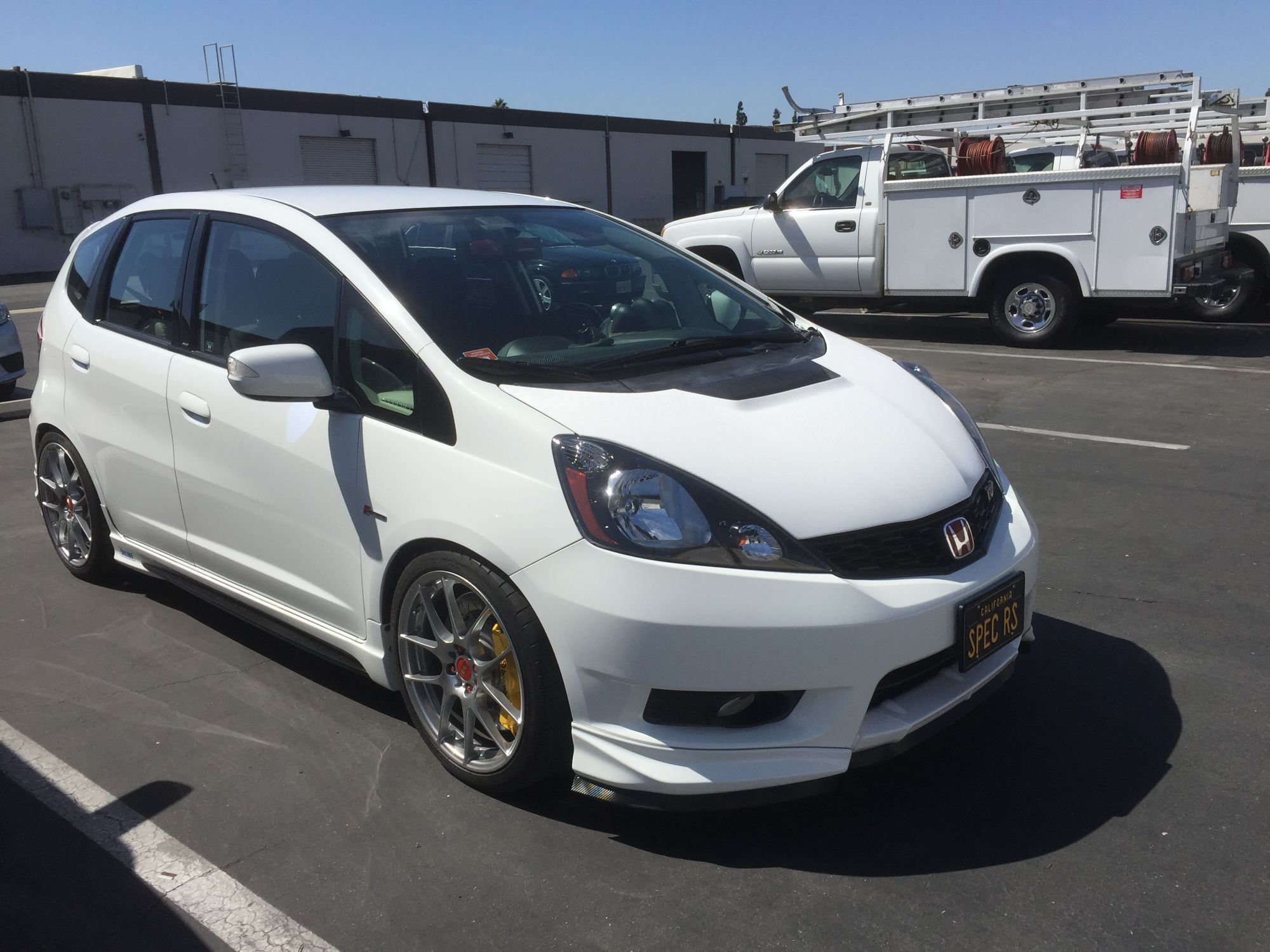

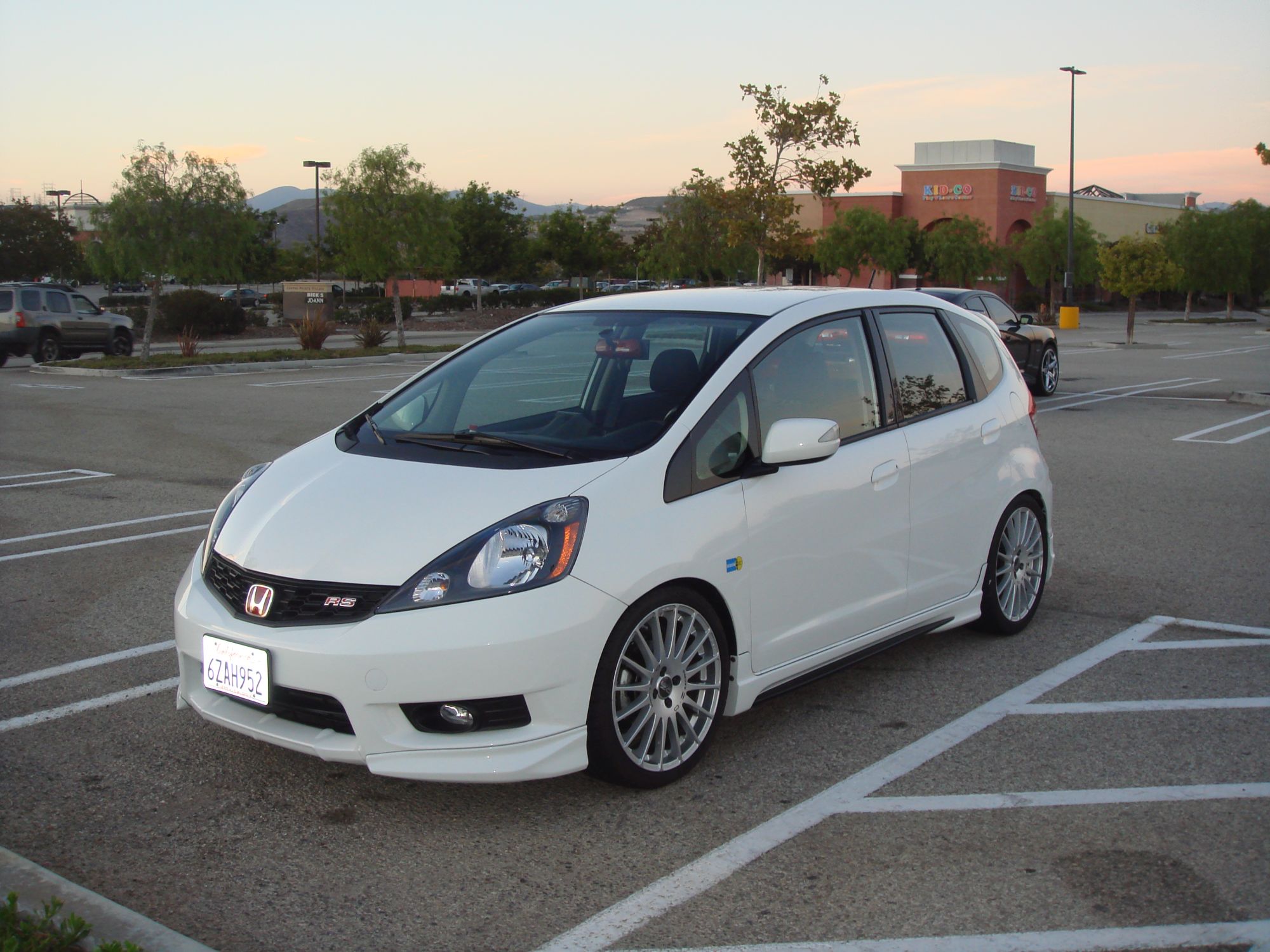

Here is picture of my car for your reference:
With BBS RF-509 18x7.5 et48 and Michelin Pilot Super Sport 215/40ZR18 (15mm spacer)
Previously with OZ Racing Superturismo GT 18x7 et42 and Michelin Pilot Sport 225/40ZR18:
