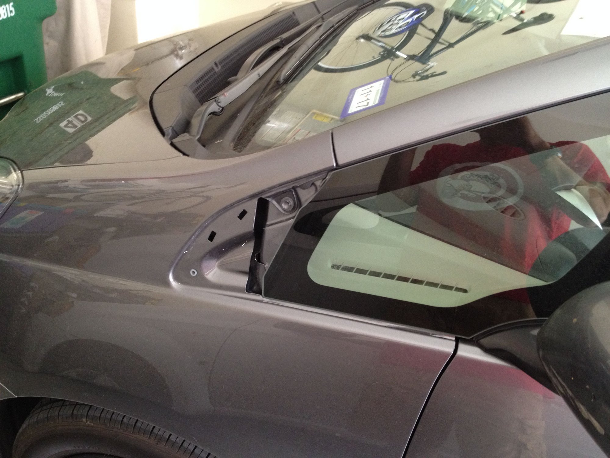

Hello all,
So, I noticed the other day that the plastic cover near the driver's side windshield glass is missing... I need to buy a replacement, but have no clue as to what this part is called. I'm not even sure how easy it is to find this part? I drive a 2013 Base Model. Can anybody help with this? Here's a good photo of what I'm talking about:
It's now all exposed and I'm sure when it rains, there will be a whole lot of water getting in... Thanks in advance.

Pretty sure thats 17 or 19...always confused what they consider Left and Right. Think Driver side is LEFT...I think..lol

I'm pretty sure this is what you want. Walk into your favorite Honda Dealer and have the parts guy look it up and order it. If he looked it up and it is wrong then he will get you the correct one with no additional charge.
2013 Honda FIT 5-DOOR SPORT (SAYAMA PLANT) GARNISH ASSY., L. FR. CORNER PILLAR - (75495-TK6-A01) - Honda Parts Online : Honda Parts Unlimited | Genuine OEM Honda Parts & Accessories
