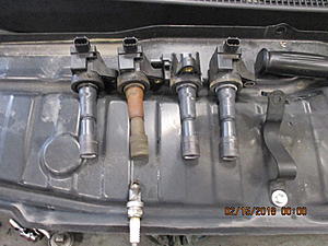

I wouldn't have believed it but the gas smell was a loose plug. Have changed hundreds of plugs over the years, in iron and aluminum heads, and have never seen this! #2 plug had backed out to the point where the car refused to start. Cleaned the plug, torqued it and the other three to spec and all is well again. Thanks to the forum for coming up with the suggestion! See the discolored #2 coil pack in the picture.

My #2 coil pack looks like that as well and the factory valve clearance on the #2 cylinder was way too tight as well.
