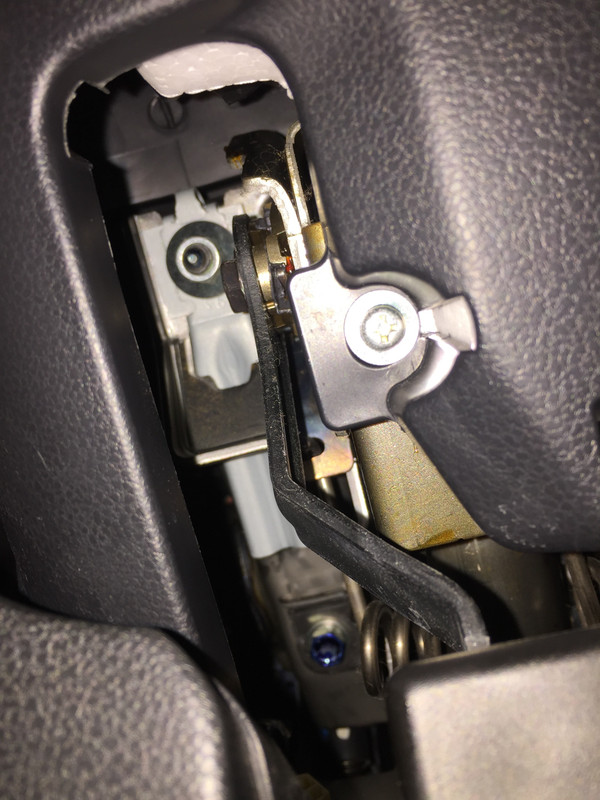

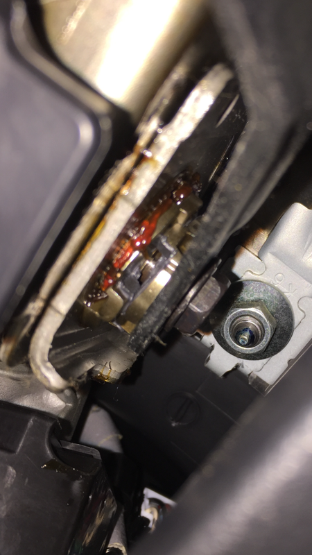

Would like to say thanks to everyone for their input on the thread. Vanct nailed it. Went to the dealer today and spoke to the technician. Per the technician, he said it’s normal for this part of the steering wheel column to be ‘greased’. He said that he thinks it was a hot day and some of the grease liquified and dripped down into the dash plastic. More or less, monitor it and if any issues, the dealer would be happy to take a look at it again. I have no slop in steering or issues with adjusting the tilt.
These are pictures looking UP from the floor towards the roof. I’m not sure if the grease is supposed to be for the tilt mechanism or what; the tech didn’t give me much of an answer.
This first one is the tilt mechanism
This is zoomed in on the ‘greasy’ part.
