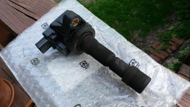

What do the coil packs look like? Are any coated in black / brown soot? Do any have the odor of gasoline on them?

^they were actually fairly clean. Maybe some very very light white/brown marking but nothing that didn’t look normal. I will probably buy some OEM plugs and snap some photos when I install.

However, your coils all look nice and black (brown is a sign of a leaking plug) so, I don't think you have the dreaded leaking spark plug issue.

If those plugs are in their respective coil packs, to me, it doesn't look like you have any blow-by from a loose plug. You can see how mine was sooty and also had odor of gasoline. I'm still using this same coil pack on same position but a new plug with a dab of blue threadlocker. No problems over last +30K miles. Damn dealer got me for a new coil pack plus labor & original diagnostic ($160 + $50 +$50) and never checked the plugs, so CEL back on the next day. They said, "Oh, you must need another coil pack." What a scam. Several yrs later, I talked to a tech who was in a welding class with me and he said loose plugs on FITs in a "known" problem. So, changing / charging for coil packs is just a money maker not true customer service.
