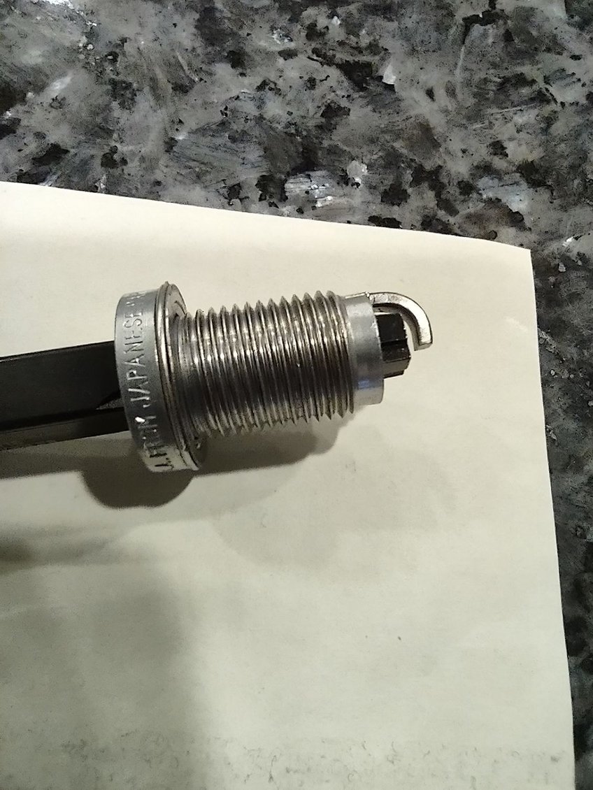

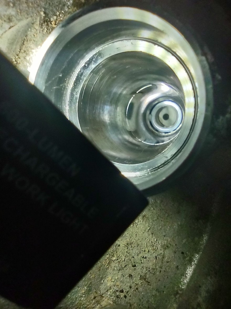

While installing new NGK spark plugs into my 2013 Fit, I snapped off the top of one of the spark plugs while using a torque wrench to tighten to 13 foot/lbs. No idea how or why it happened. I swear on my mother's life I didn't hulk out. And now I'm in full panic mode.
Does anyone have any experience removing a broken spark plug bolt? Any recommended tools or techniques?
Thanks in advance.
The top of the broken plug.
Looking down at the remaining part of the broken plug.
