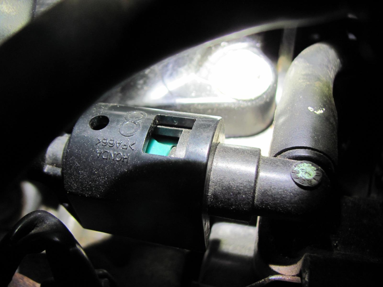

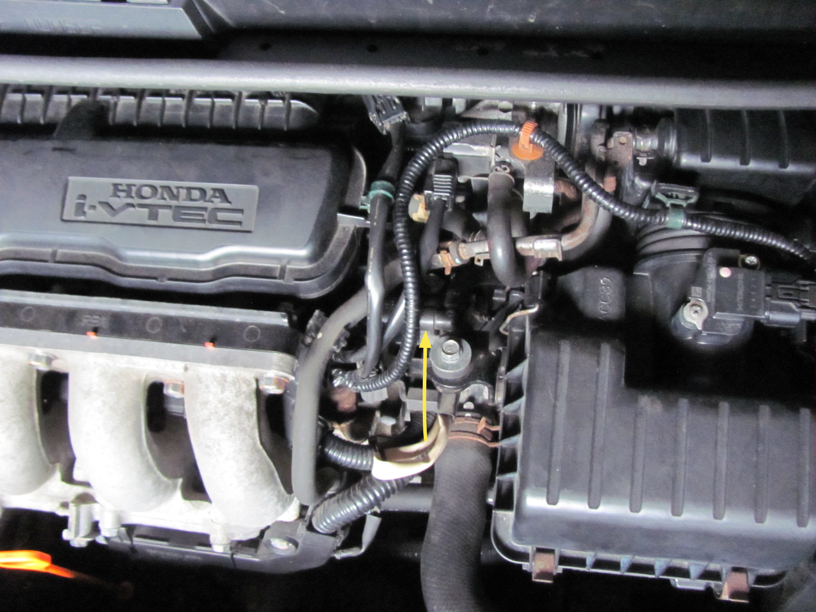

I have received a PM from Elavanis requesting help finding the fitting used to check fuel pressure. I took a few pics and hope they will help.
Here is the engine of my 2010 Fit. The arrow points to the quick-connect fitting where fuel pressure is tested.
Here is a close-up
The piece with the square hole needs to be pulled off to reach the fitting.
Press down on the turquoise colored tab at the left and the fitting will separate.
