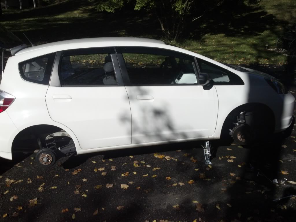

For rotating the tires, you can (though I don't reccomend I, since I did it in a pinch when I got a flat on the front) get a whole side up just on the emergency jack if you find a slight hill. The fit is that nose heavy.
Proof: (yes, I know it's dangerous, make sure to put some sort of support on the back when you get it up! The ground happened to be shaped to where this wasn't going anywhere, while the tires were still on I gave it some good pushes in avrious directions to test stability before proceeding)

The only especially dangerous thing I see in this shot is that you are using the factory scissor jack for something other than an emergency. I've had a few of those bend or fail catastrophically over the years, one of which left me lucky to still have both my hands.
That was an emergency. I was putting the spare on the rear with a flat front.
I actually use the factory jack fairly often when working on the car, but I use it on the rear only in that case, in conjunction with a nice little hydraulic one on the front to lift up a side of the car.
