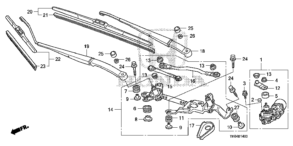

Hey folks, my wiper linkage bushings are worn out and I'm having a tough time finding aftermarket replacements. Has anybody found bushings that'll fit, or are people just buying a new arm? Any advice is much appreciated!

We've had worn wiper arm bushings on other Hondas (not the Fit, yet). Usually, only one of the link arms is the issue.
Yes, Honda only provides the bushings with the entire arm.
Not that pricey, though. If you have the time, inspect the worn arms to see exactly what you need. (I was lazy and ordered BOTH arms the last time but didn't need to)
76540-TK6-A01 15 ROD UNIT A $ 6.38 USD #15
76550-TK6-A01 16 ROD UNIT B $ 10.22 USD #16
Credit: Hondapartsdeals.com
