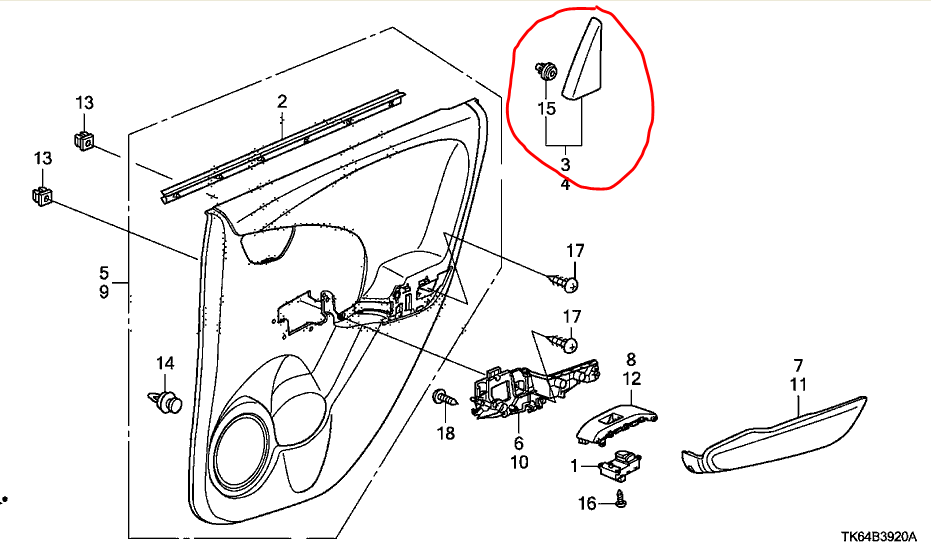

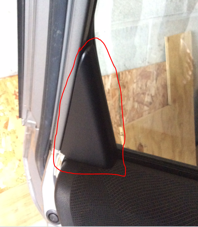

I broke the screw or pin off of this trim piece when removing it driver's side rear door (2010). I have it taped on but I really should replace it. Can someone help me identify the exact part for my car? I was just guessing at the manufacture plant on this site.
72940-TF0-003ZA - Genuine Honda Garnish, R. RR. Door Quarter (Inner) *NH167L* (GRAPHITE BLACK)
72980-TF0-003ZA - Genuine Honda Garnish, L. RR. Door Quarter (Inner) *NH167L* (GRAPHITE BLACK)
What looks like broke might be this piece:
91610-SED-003 - Genuine Honda Grommet, Garnish (Inner)
Sorry but this is all very confusing to me, Maybe I needed to unscrew something instead of trying to pop it off?
And perhaps some epoxy would be just as good to get it back on?
Attached Thumbnails Rear Door Trim Piece-rear-door-trim.png   Rear Door Trim Piece-rear-door-lining-2526294.png   Rear Door Trim Piece-80-rear_door_trim_a030980942eb8b4d1619451337d7921413effcba.png   Rear Door Trim Piece-80-rear_door_lining_2526294_1b53bbabffc06c0a48e0116e5e4cf5e5645b85cf.png

Take off the trim piece and look if the retaining clip is broken or if the slot on the back of the trim piece is broken.
You have the right parts listed.

How do you take this piece off without breaking it? I need to do the same thing to get access to the lower fastener when I replace the outer garnish molding on my own car.

I have removed a cover very similar to that cover on the front door (where the door mirror) is located and you just use a pry tool to pop it off. Most of the plastic covers on the GE are pop offs. Just be gentle when you pop it and lift until it comes off.

I broke one on the rear then figured out they slide upward if I recall, still havent fixed the broke one you just reminded me...
