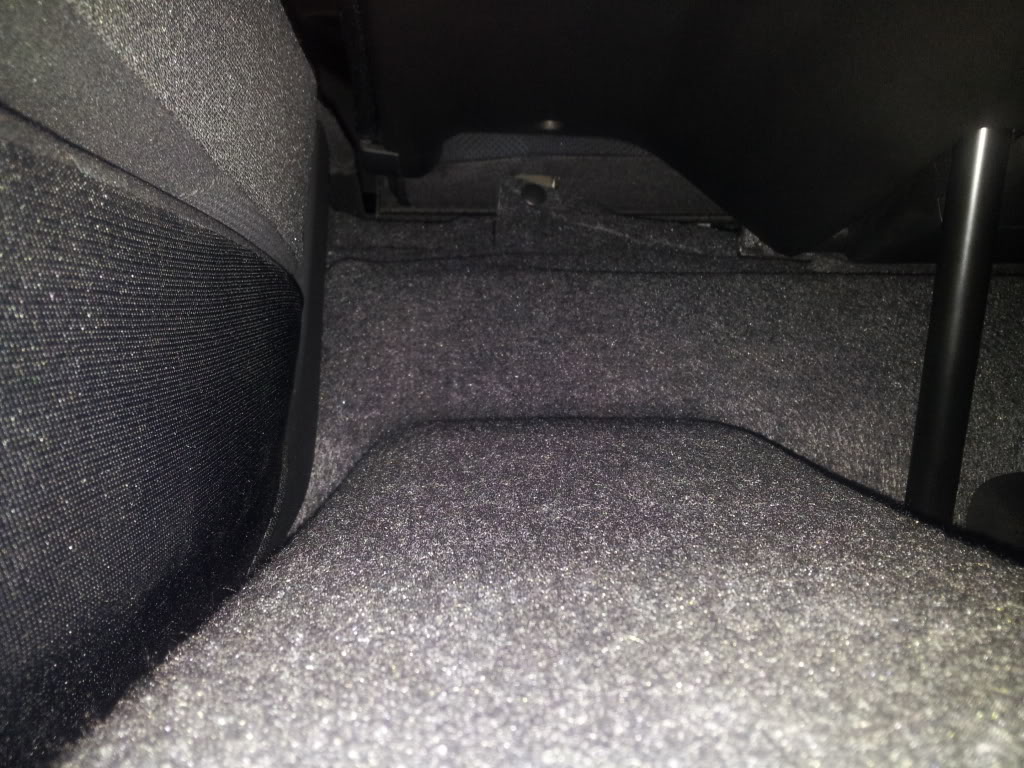

I gave the Fit a long hard look and with the passenger heat vents, the seat bottom height, and full seat travel - I came up with nothing. Now we all know that it all comes down to time and money and anything can be done.
I know the spare tire in the Honda Fit has been ditched in the past, and I've done the very same in my 1995 Buick Roadmaster Station Wagon. Spare has been gone for years and 2 JL10W1s have lived there happily. My days of living on the edge are over though. Without taking the center console out, it looks like there is not much usable space near the front of the center console in front or under the beverage holders for anything worth while.
Now I have to wonder - has anyone tried anything with the space BACK HERE?

The center tunnel space lends itself to a front firing 6.5 inch or possibly 8 inch sub, while either side of car you have room for a compact amplifier to clear the metal flip down seat support bar. Wire Mesh cages to keep the amps protected and ventilated?

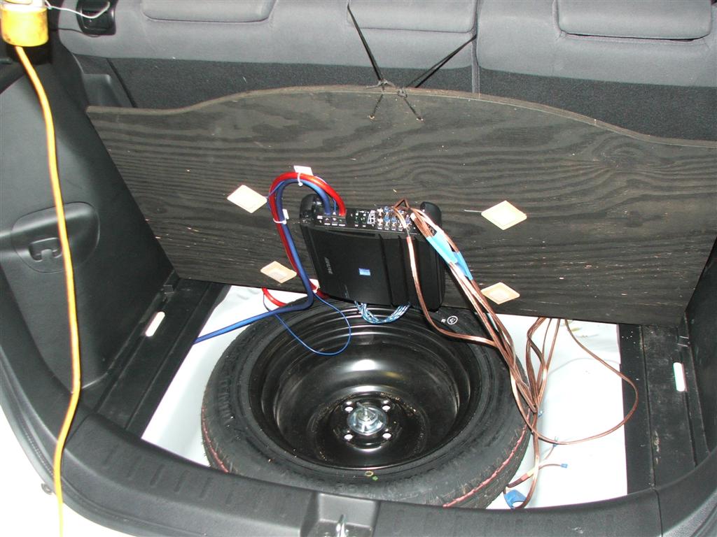

I can't comment on subs since I am running a 12" The Punch Audiophile in a ~1.5ft^3 sealed box (still plenty of room next to it).
For the amp thoug, I did this. You need to measure carefully and use a small 3 or 5 channel amp (class D is perfect for this) but you can hang the amp in the spair tire. With using the spair 3 times in the last year, I am glad I didn't ditch it!
