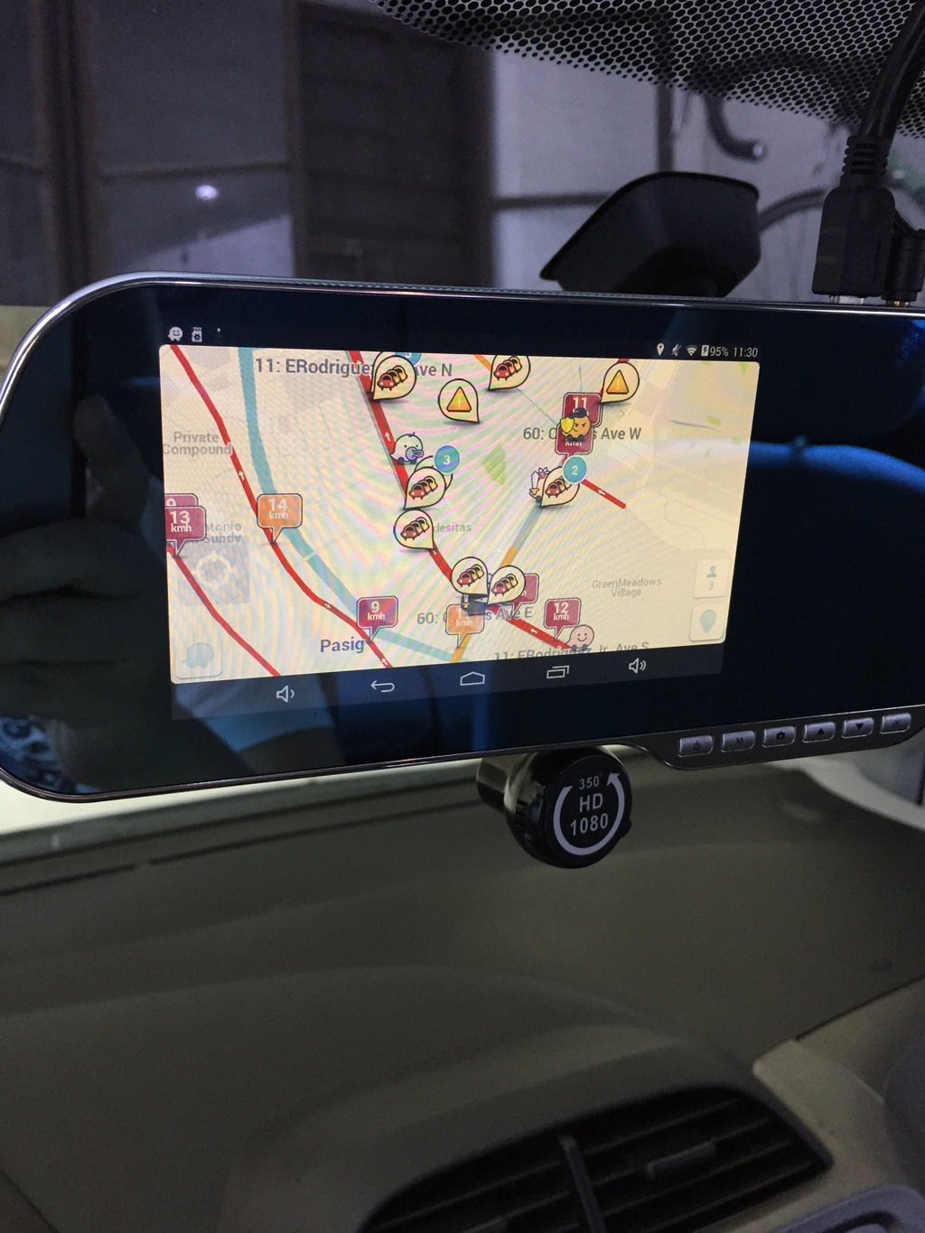

Personally, I like it so far because I use Waze for my navigation as it provides real-time traffic information (vital in dense urban traffic situations) and have Spotify running in my car. I no longer need to keep my USB flash drive for my music updated when I add songs.
This is how it looks installed in a Honda GE Jazz (Fit)
I installed Waze using Google Play on it.
Spotify to keep my updated on the best music while in traffic.
All-in-all, a cheaper cleaner alternative to a pricey Android Head Unit without changing the design of the dashboard of the Honda Jazz

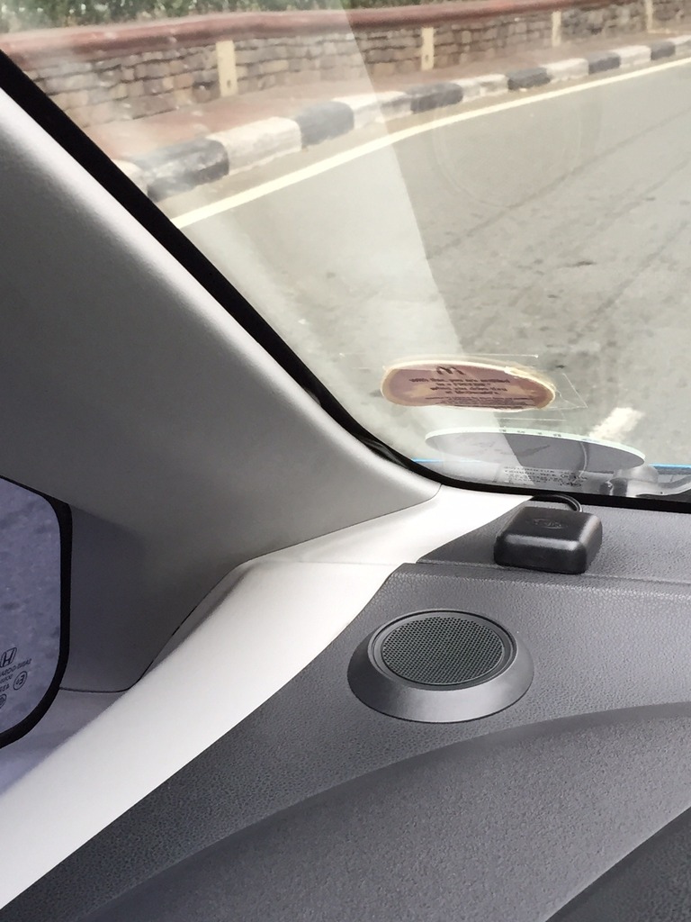

This is the GPS Antenna mounted to the portion of the dashboard nearest the windshield.

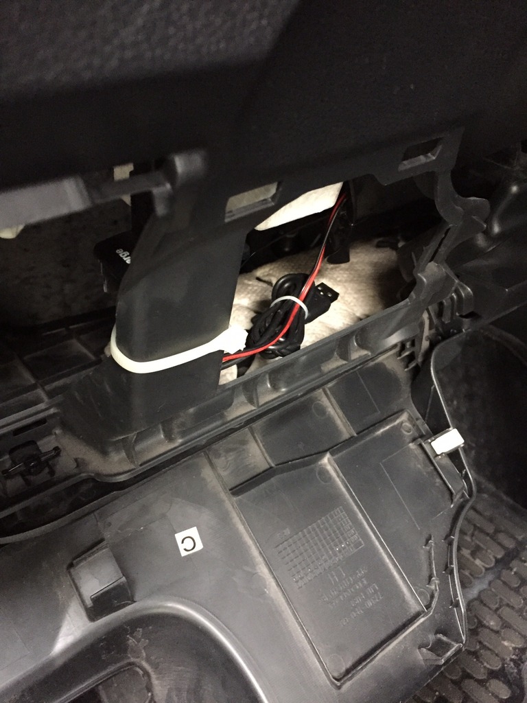

This is the image of the 12V to USB port. The red/black wire is tapped into the existing Cigarette Lighter wire below the radio so it's fused.
A closer image of the USB port. That actually can mount to the dashboard but kinda useless if I have USB port exposed with something in it 100% of the time so I chose to hide it.

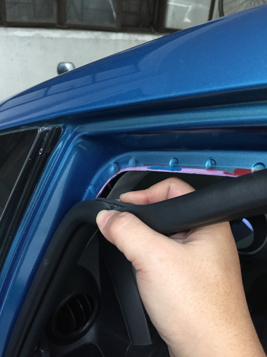

You have to remove the door weatherstrip to reach the plastic mouldings in the cabin to route the wire.

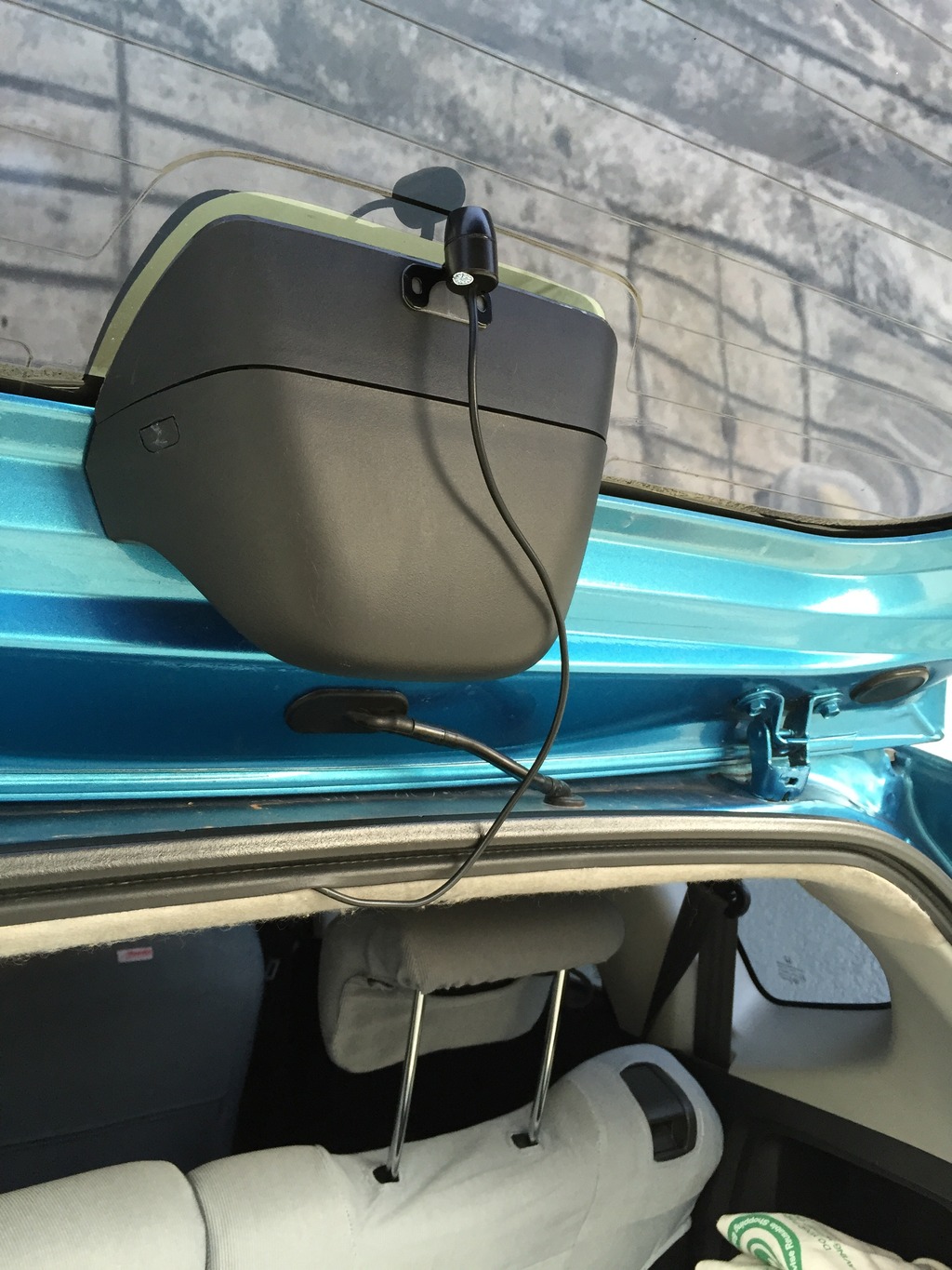

This is the rear camera. I just double sided it to the 3rd brake light (for now)
