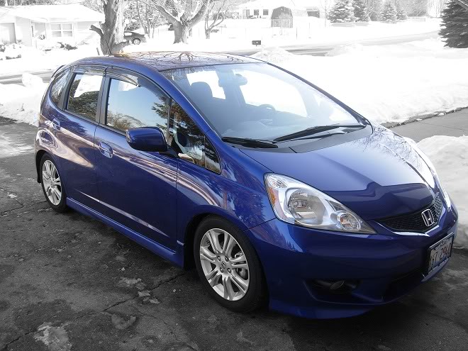

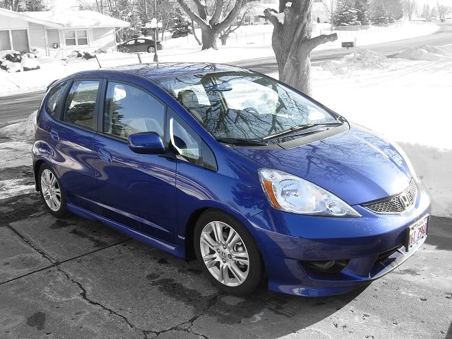

drove up to kingmotorsports last weekend and picked these up. Nice day so I decided to install them. Frozen fingers but the result is all that matters. I didn't have much room to take a nice side shot, didn't feel like standing in snow to take the shot.

it isn't difficult at all. All the instructions were in japanese tho.
All you do is:
put down your windows
pull down the weather strip a little and stick the clips in, don't worry about getting them to the right spot, they slide around easily.
Put the weather strip up to hold the clips in place.
Take Alcohol Wipe (provided in box) clean the surface.
Peel and stick on the Visors.
Then stick the litte buttons in place.
Took me about 10 minutes, but i've done it once before on my si. Was also cold and in a rush.

LIES! Just look at the shadows in the before and after. The sun damn near disappeared. I'm guessing 30 minutes at least.
Probably just had a cold beer after the install. Took the pics later.
