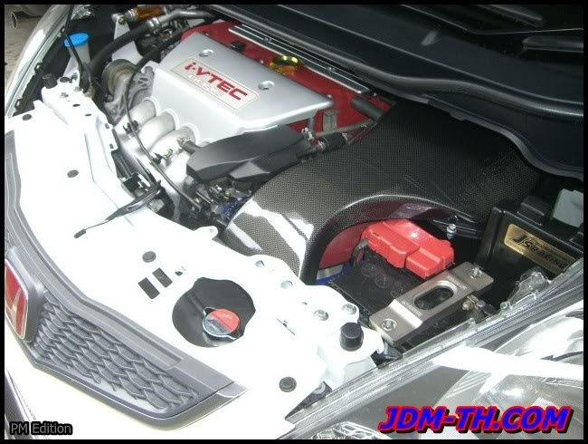

I think you're gonna have a hard time getting the RBC to clear the rad support...especially the hood latch. The RBB PRB or RSP might be an easier fit....or ITBs like Js Racing!

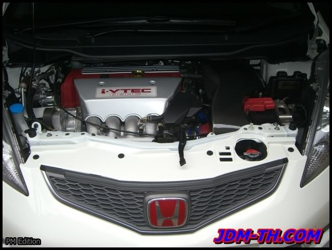

I've seen some pictures of k ge8 from Asia and hopefully with our longer nose the rbc will fit, or I'll attempt to make it fit first. Lol If not I still have my prb mani that came with the motor.
*note* our hood latch is on the other side of the radiator support

I am running the OEM radiator on my K24 GD and have very little issues. Water temps are normally around 190F in the summer. I never have really seen under the hood of a GE but at most you might endup having to make new mounting brackets for the radiator. Another option for the intake manifold might be the skunk2 manifold. I think it's half inch shorter then the RBC. Anyways if the RBC can be made to fit in the GD it should work in the GE
