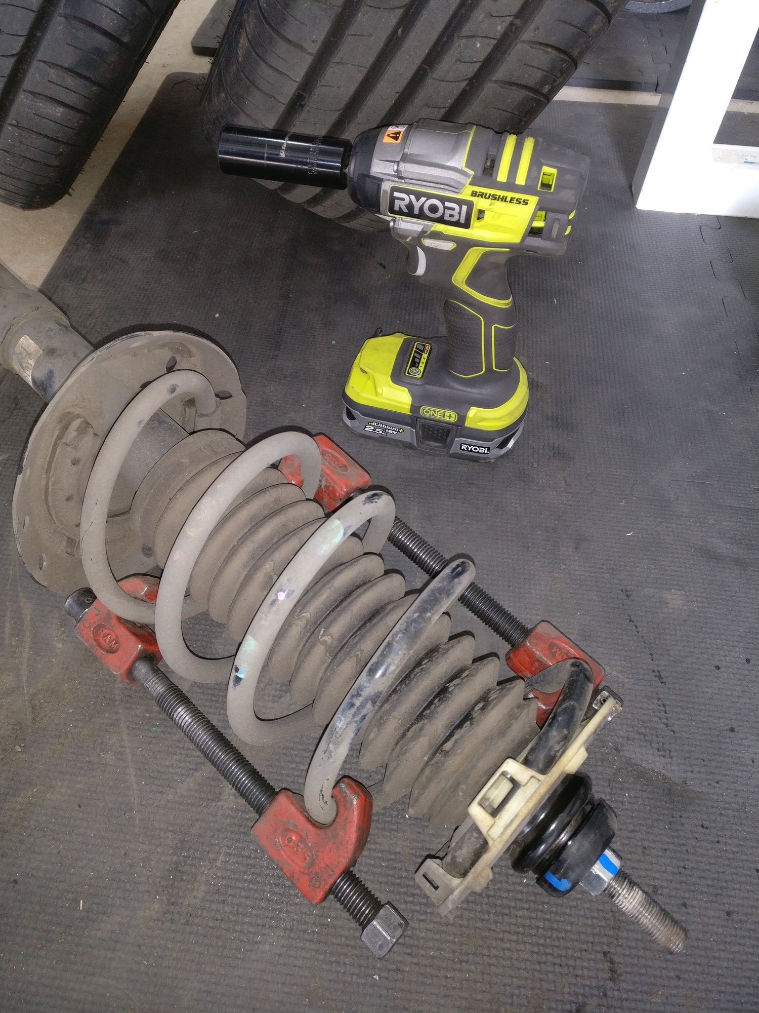

I did the fronts yesterday. After reading about the drive shaft popping out I made sure to support the control arms when removing the struts.
Again, there was no left or right orientation on the springs, just front and back. So I installed with the Tein logos facing the right way up.
I read somewhere that you don't need to cut the bump stops on these springs for a GE. This is NOT true according to the manufacturer. They recommend cutting the front (bottom) section 1.4 inch or 35mm, so I did.
Took it for a test drive. The car does handle very differently now. A lot of the body roll has been reduced. The ride does feel a bit tougher over harsh bumps but I was expecting that.
I didn't take any before shots, buts definitely dropped the height by the stated 1.5 inch or so at all corners. The good this is this is all reversible if I get sick of it and want a stock ride,, but I'd probably have to buy some front bump stops which are dirt cheap.
I managed to do the fronts in about 3 hours taking my time. Decking be able to smash it out in about 2, now that I've done it. Having an impact wrench definitely made the job easier and quicker.
As promised here's some pics of the front springs installed and a couple of shot of the tyre gap and side shot. Cheers from down under
