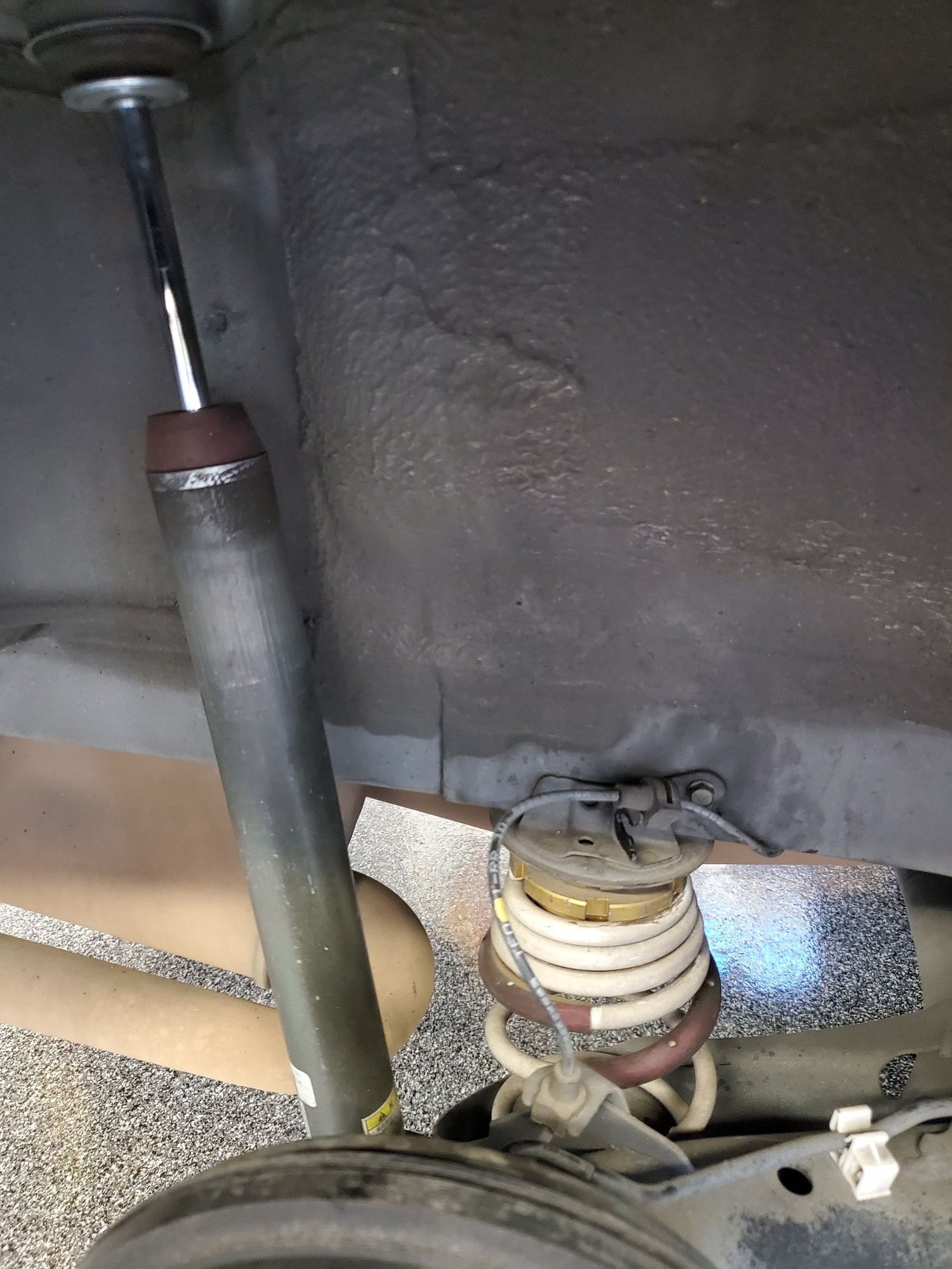

Finish and machining looks good, spanners gripped on to the locking collars solidly and the locking collars spun very freely on the shock body. The rear spring perches came with two set of rubber dampening (top and bottom) which was nice, since my HKS rears only had a rubber spring seat for the bottom, but not the top where the threaded spring seat interfaces with the body. Also, the rear spring perches from the MaXpeedingRods coilovers look to be made from billet aluminum compared to my HKS spring perch made out of steel. Small weight difference, but a weight difference nonetheless.

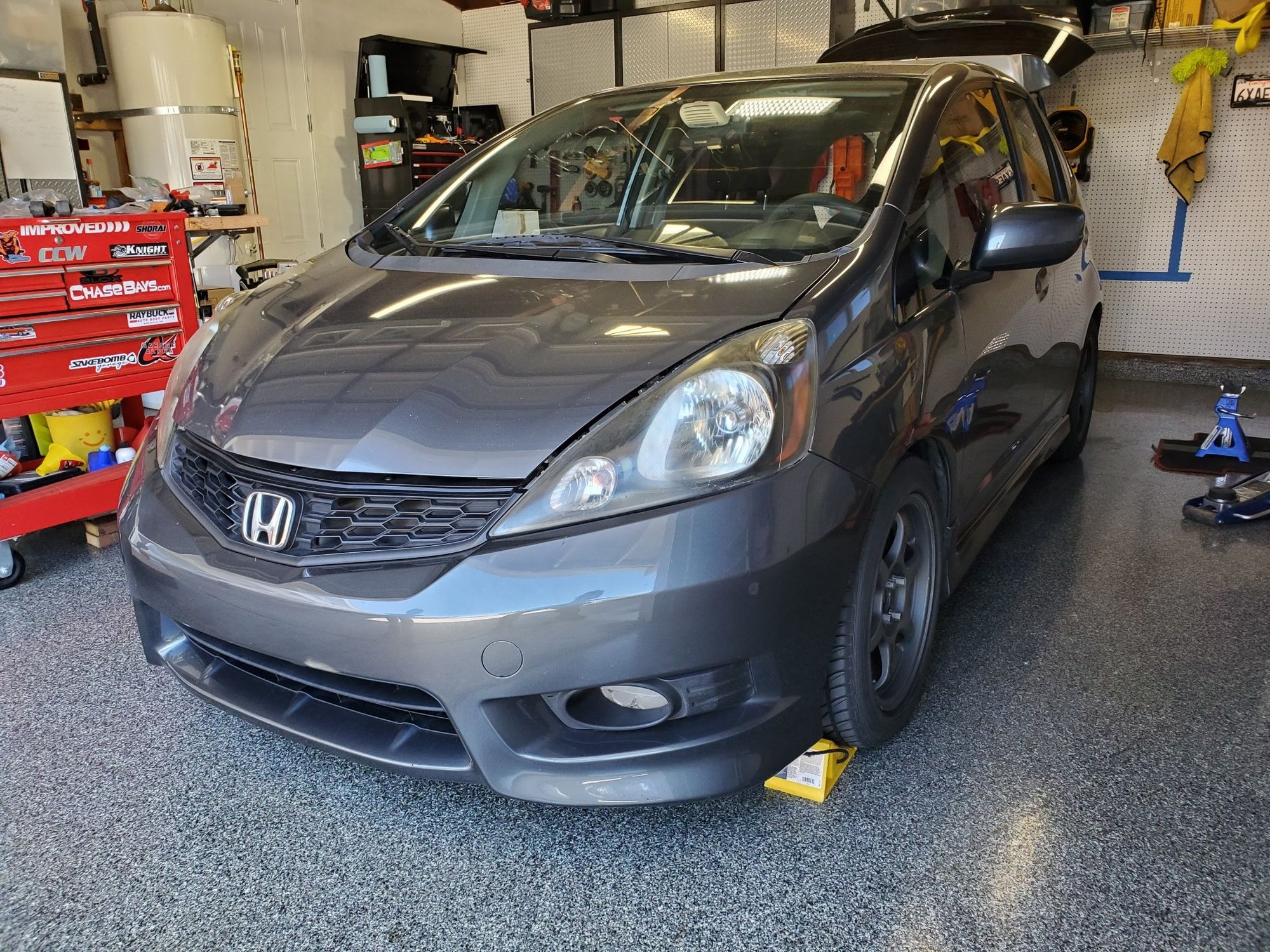

2013 Honda fit sport, GE8
16x7 +43 SSR Type C rims, 205/50/16 Ohtsu FP7000 tires
Progress rear sway bar

Springs are quite a bit shorter than the HKS
