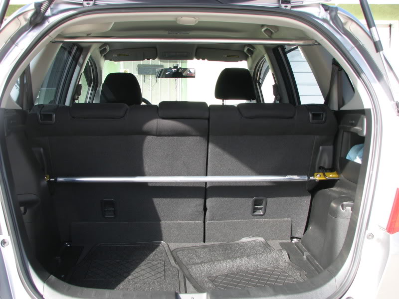

J's Racing Rear Strut Bar:
Driver Side Mount:
Passenger Side Mount:
Bar Installed:

Pic of both bars:
