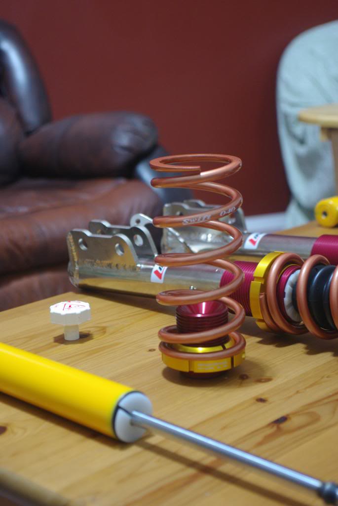

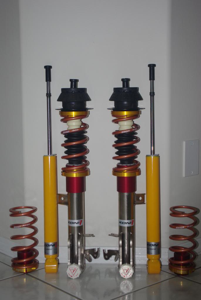

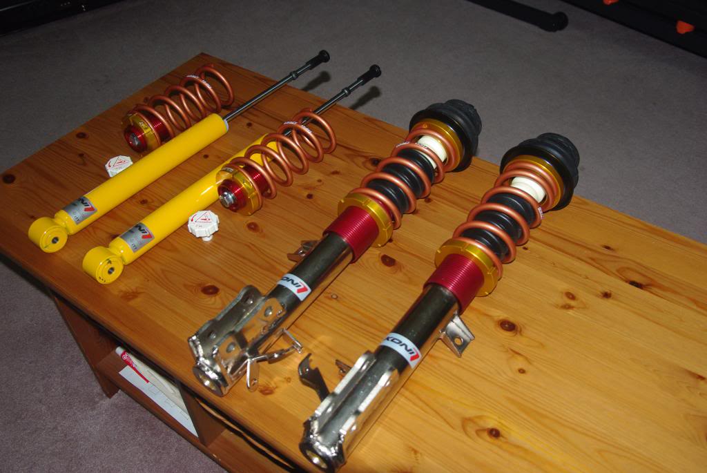

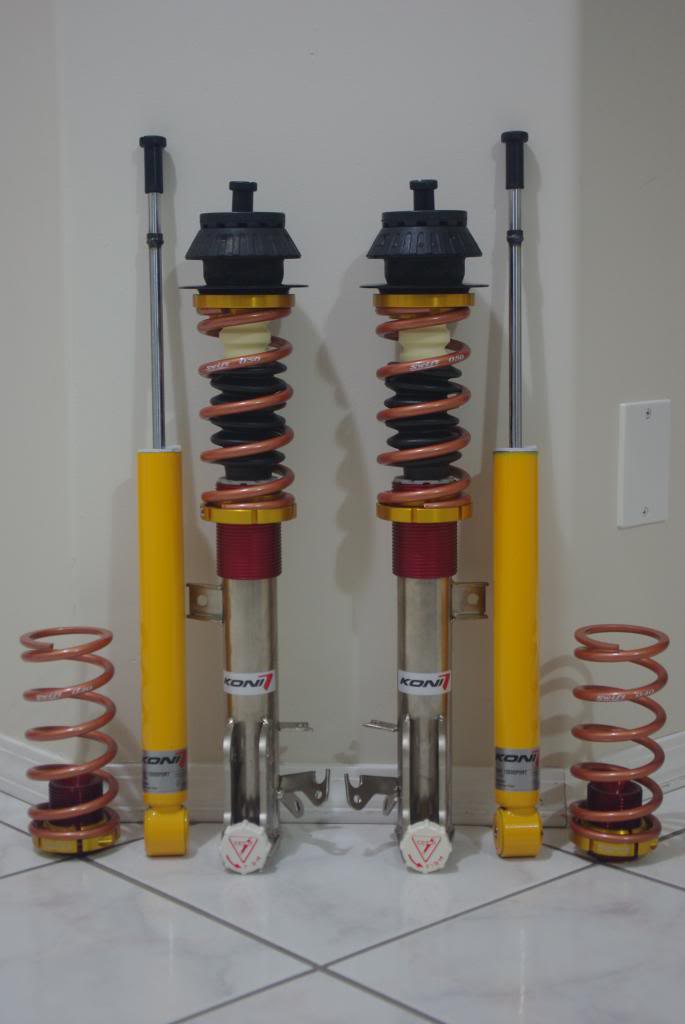

Coilovers From Redshift Motorsports
got my coilovers today from Redshift Motorsports. Can't wait to have them installed tomorrow. Awesome customer service from Chris @ Redshift. Every e-mail I sent to him was answered right away. Name:  IMGP5779_zps04b6e79d.jpg
Size:  48.9 KB Name:  IMGP5776_zps87f398b4.jpg
Size:  45.3 KB Name:  IMGP5771_zps7610f7a1.jpg
Size:  53.4 KB Name:  IMGP5750_zps6dfcb00b.jpg
Size:  69.6 KB Name:  IMGP5747_zps64ea111f.jpg
What spring rates did you go with?
Old Sep 17, 2013 | 08:36 PM
  #108
funfactor's Avatar
Joined: Jun 2013
Posts: 14
From: British Columbia, Canada
5K front, 4K rear, with the swift springs upgrade.

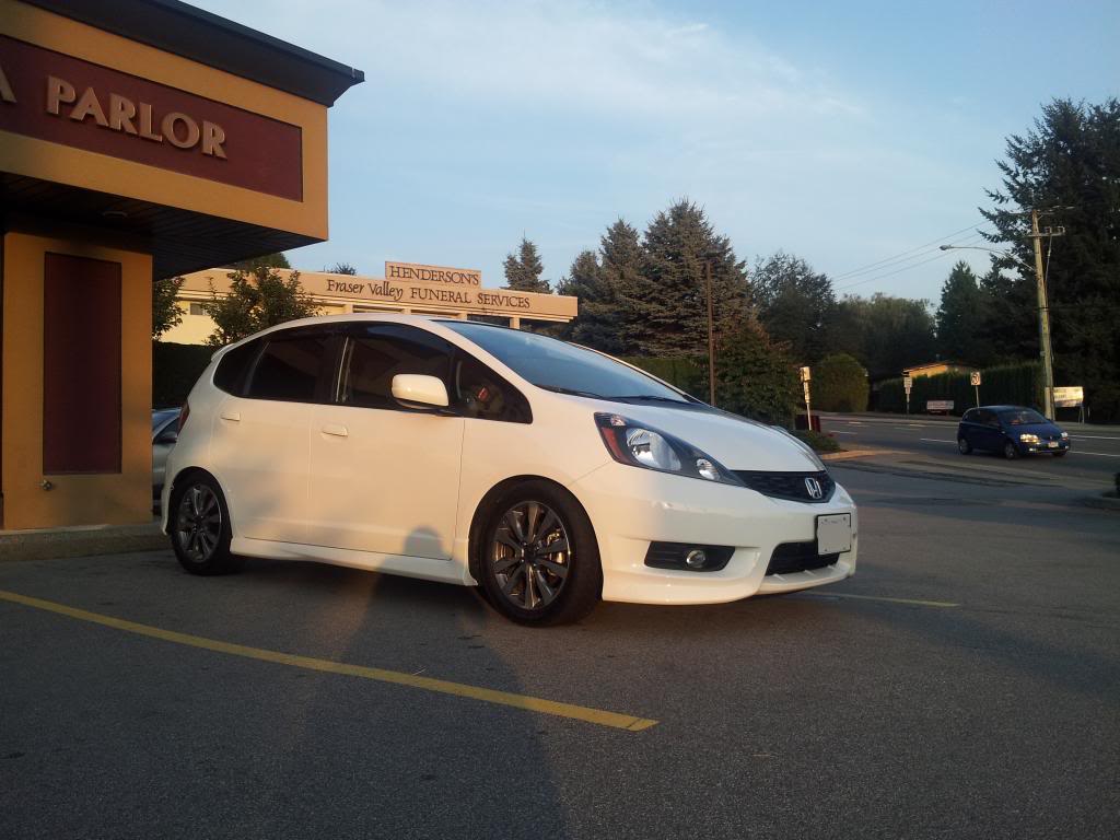

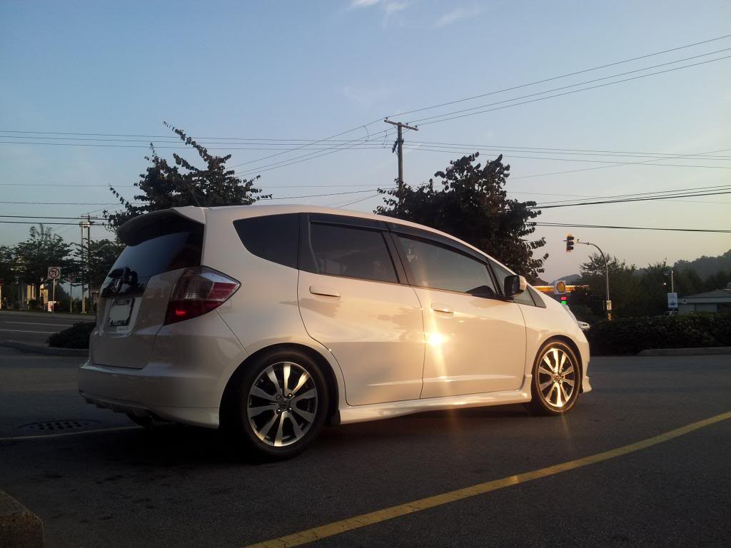

Here Are A Few Pictures After The Coilovers Were Installed.
Size:  87.8 KB Name:  20130914_184538_zpsf336038d.jpg
How is the ride on the coilovers? I've been waiting for Koni setup as I love them on my integra.
Old Oct 29, 2013 | 10:32 PM
  #112
funfactor's Avatar
Joined: Jun 2013
Posts: 14
The ride is great it handles very well and is very streetable with 4k and 5k springs, I think it is a very worthwhile upgrade.
