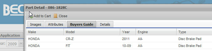

I have been wondering the same thing. I am getting all kinds of information all over the interweb.
I have found on some brake pad manufacturers websites that the GE8 Fits and 2011 CR-Z uses the same front brake pads:
From Beck Arnley website:

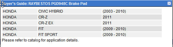

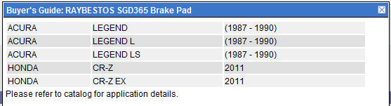

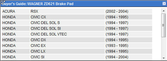

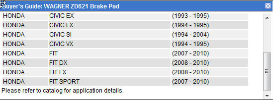

I then found this info at RockAuto regarding brake pads.
Next 2 are same pad:
When you start to look at all the backward compatibility it looks like 80% of the Honda over the past 20 years use the same front brake pads.
I hope that the RockAuto data is correct. I like the site and order a lot from them for my cars and have not had any issues.
There is no real comparability grid based on brake pads OEM or Aftermarket that encompasses all the cars out there ( at least that I could find). There has to be a large degree of interchangeability among the different platforms from the same car manufacturer or they would have one hell of a parts database if each platform had unique parts.
If anyone else can validate some of the findings I have produce please feel free because it gives me a headache when according to some brake pad manufactures on a pad being compatible between 2 cars, the OEM part numbers are different so no way of matching them up.

No they aren't the same, rotors may interchange, but calipers are different. EBC lists FMSI # D1394 for the 2009- Fit and 2011 CR-Z fronts. That is different from the FMSI # D621 listed for the early Fit, non-S RSX Acura and several other Honda products. Are they close enough to grind/hammer to fit? I dont know and dont care. I wont modify parts like that when the correct one is available.
EBC lists three part numbers for the front pads
UD1394 Ultimax OEM Replacement
DP22041 Greenstuff 2000 Series (I liked these on my BMW 325i for street use.)
DP32041C Redstuff Ceramic (found in one EBC listing for CR-Z, but no one carries it, yet?)
The Hawk HPS listing by some on-line retailers is wrong, HB418F.646, which is really a D621 pad. Has anyone has used this one without modification?
