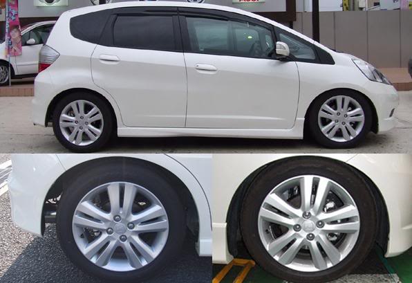

Stock GD suspension on GE
Mugen GD suspension on GE

Yes?? Good question! Are Stock shocks with gd springs being used? More info please. And that white ge8 pictured, is that really on stock gd suspension? Any more pics? Who owns it? Link to thread or more info??

What i've seen is that: yes you can put GD springs on the GE perches, but it's definitely a less than optimal setup between the spring length and rate. I haven't found many pictures or threads detailing this so I am curious.
