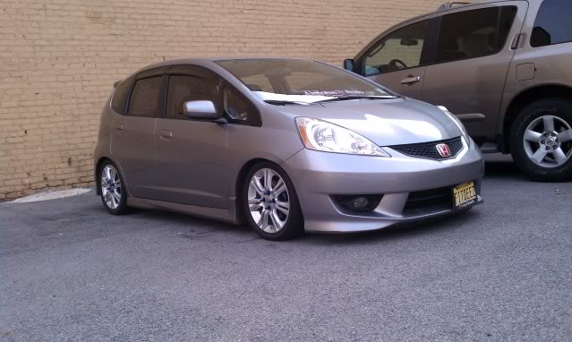

I got 205/40s on my stock wheels
Why 205-40's? Thats like ~1.8" overall diam difference. Your speedo will now be off.
205-50's is only .1" difference.
I do admit you are now slammed...looks good.

I'm always slamming it
I like how the stock wheels look with a smaller profile tire
ah I see.
Old Nov 30, 2010 | 09:09 AM
  #51
Black3sr's Avatar
Posts: 4,250
From: Kitchener,Ont Canada
I like your look but I doubt if I could handle the ride. It must be much rougher.

From: NJ
It's actually not bad my girl says its smooth she always falls asleep lol

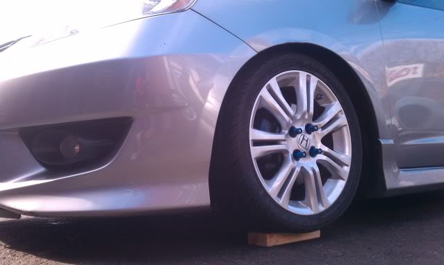

Those with 205/50/16s, can one of you post more pics of the 3/4 views of the tire and wheel. I'd like to see how far the extra width tire juts out from the wheel.

Old Dec 1, 2010 | 07:54 PM
  #60
CrystalFiveMT's Avatar
Posts: 1,662
From: New York State
Thanks for the pic, but are those wheels the same width as the GE's stock rim?
I should've specified that I'd like to see a stock GE with stock rims with the 205/50/16 size, in 3/4 view to see the relationship between the rim and tire at the bead.
