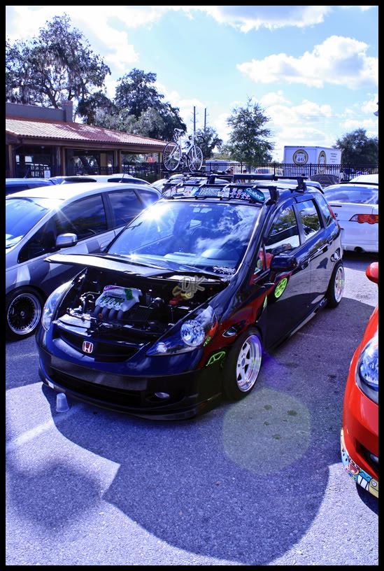

btw hootie my wheels are actully 15x8 +15 and the lip is even with fender the pic in my sig was stretch and modded this is what my car looks like now
