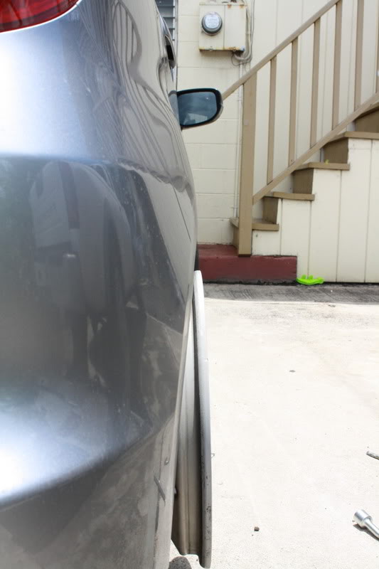

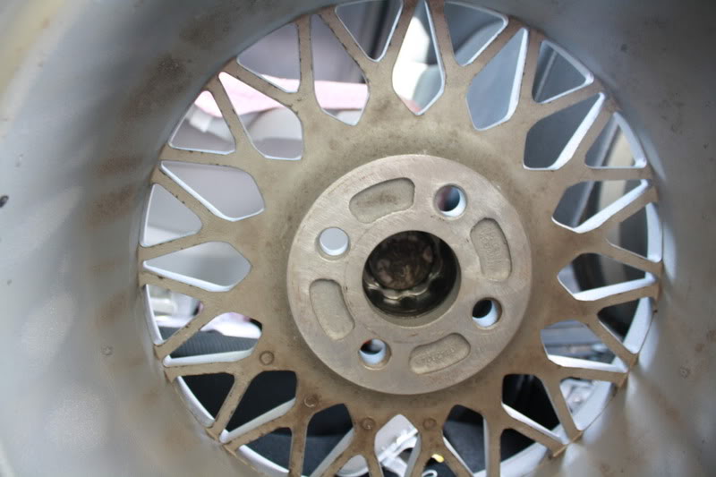

well anyway i tried mounting them today to see how they would look, the rears fit perfectly while the front had clearance issues. The previous owner said he had the 15x6 pair shaved behind the pcd holes about 3 mm or so. Which now creates the problem of brake clearance, the rim sits up against the caliper. I thought i'd put some kind of spacer but im thinking that i would have less space to screw on the lugs on the studs, am i right? I think another 5mm or so would clear up the issue because i tried mounting the 15x7 to the front and it cleared the brakes.Anyway on to the pics!
15x6 shaved comparison to 15x7. you can clearly see where it is shaved.

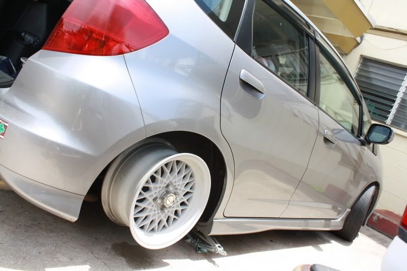

some moar pics!
REAR with 15x7

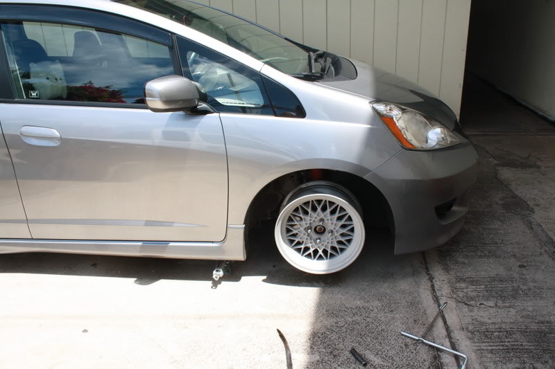

FRONT with 15x6
Thanks for looking guys, hope to hear some input of how i can resolve this issue.
Old Jun 4, 2011 | 09:41 PM
Posts: 7,624
Buy H&R Spacers, they include extended lugs with the spacers.
I'd go with a 5mm spacer.

I was thinking the same way goobers, i tried putting the 7" up front and it poked a little, could make it fit with some rolling/pull with mild stretch on the tires or buy those camber bolts, but i dont think i'll get much camber from them, am i right?
here's a pic of 7's up front
Old Jun 5, 2011 | 05:33 AM
