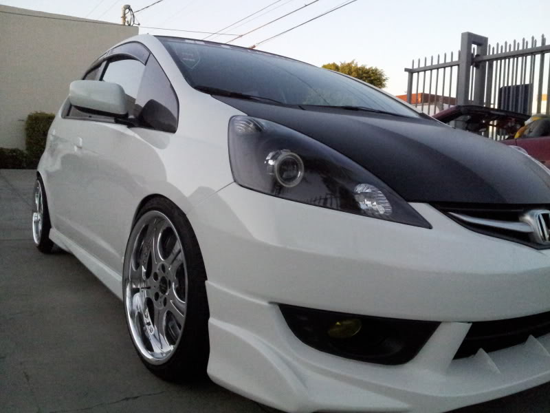

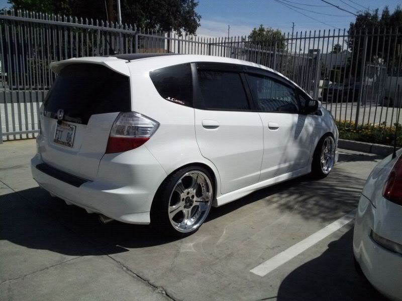

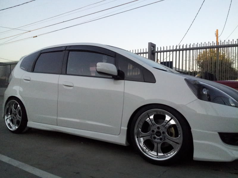

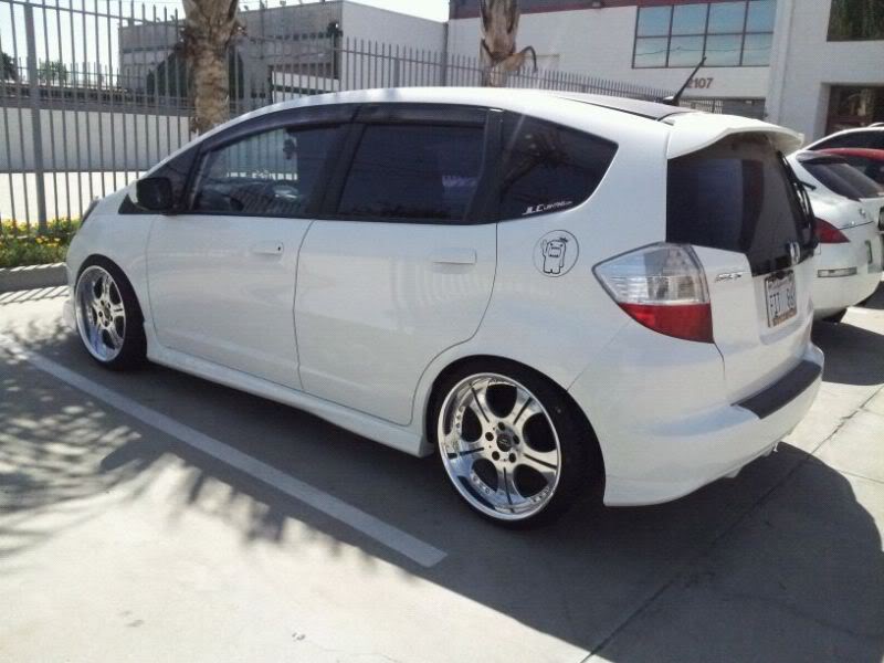

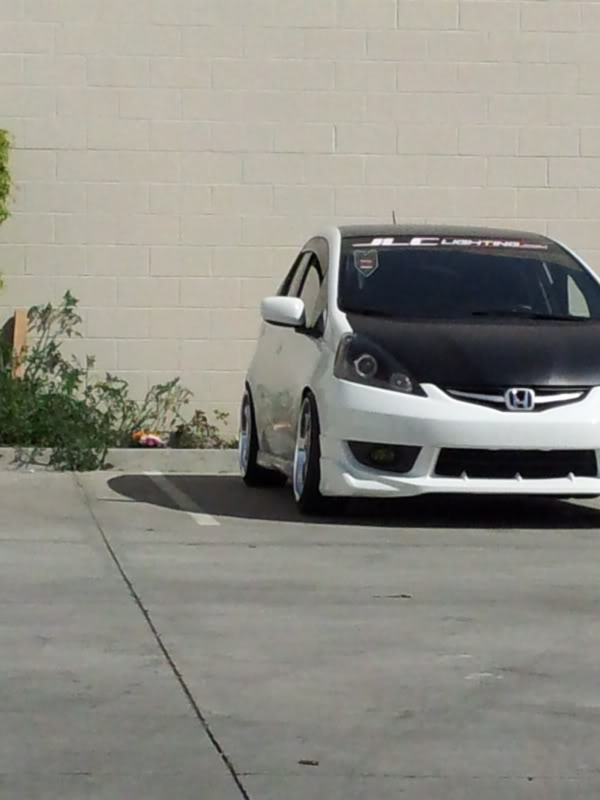

im running 205/40 on 18x8 in the front and i dont see any stretch but thats the smallest size i could find.
as for the rear im running 215/35 on 18x9 in the rear which is a pretty nice stretch.
on buddyclub coilovers & spc camber bolts (-4 degrees in front and -1 degree rear)
specs:
Works Euroline S2 full polished
18x8 +25
18x9 +35

Whats the offset?

How did u camber the rear? I thought we couldnt make camber adjust ent in the rear
