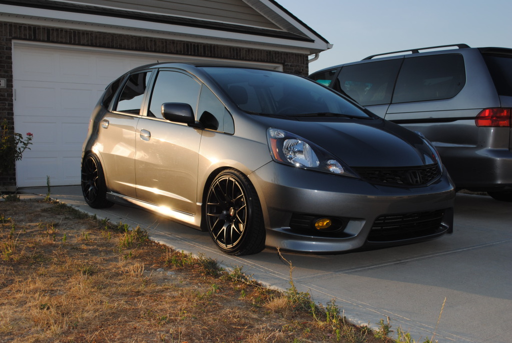

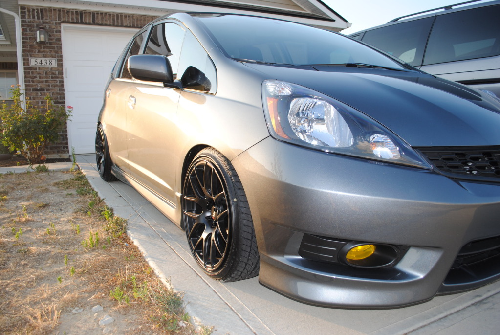

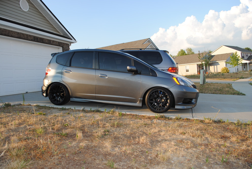

This image:
http://tunedmotiondotcom.files.wordp...7/dsc01596.jpg
and the build/progress thread here:
Hollywood*'s CBP GE8 ~THE DAILY~ - Honda-Tech

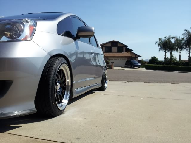

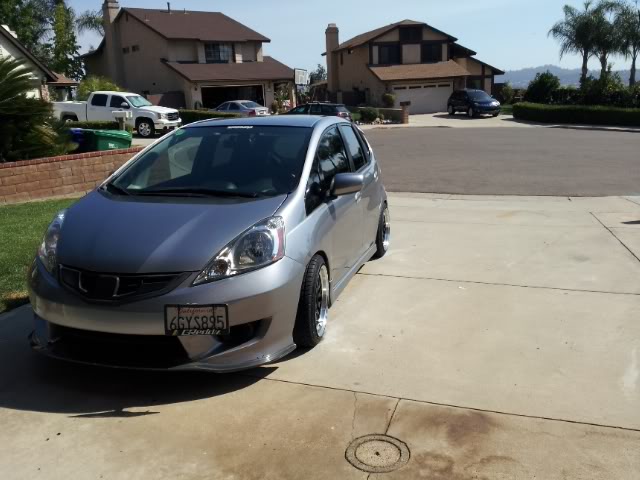

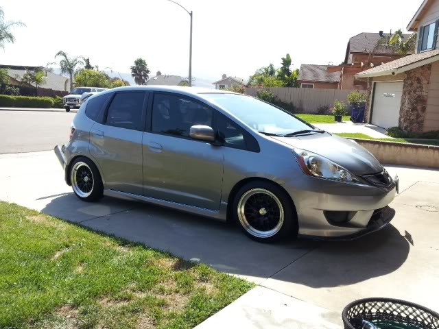

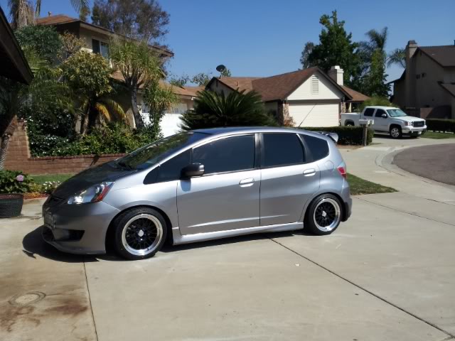

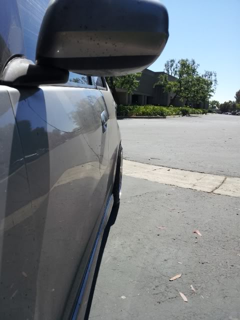

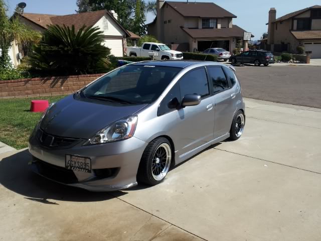

im running 16x8 et20 with a 195 45 16 tire i have pulled my fenders super far! and there is still a lil poke! i have rims that need a spacer cuz the caliper braket is in the way, a simple 10mm spacer will make it clear. the "big/legendary" brake upgrade might provide a way to correctly remove this bracket.

if you run the same set up as me, it will stick out over 1in. i have spent super long trying to pull the fenders that far and it has near an in. of poke now

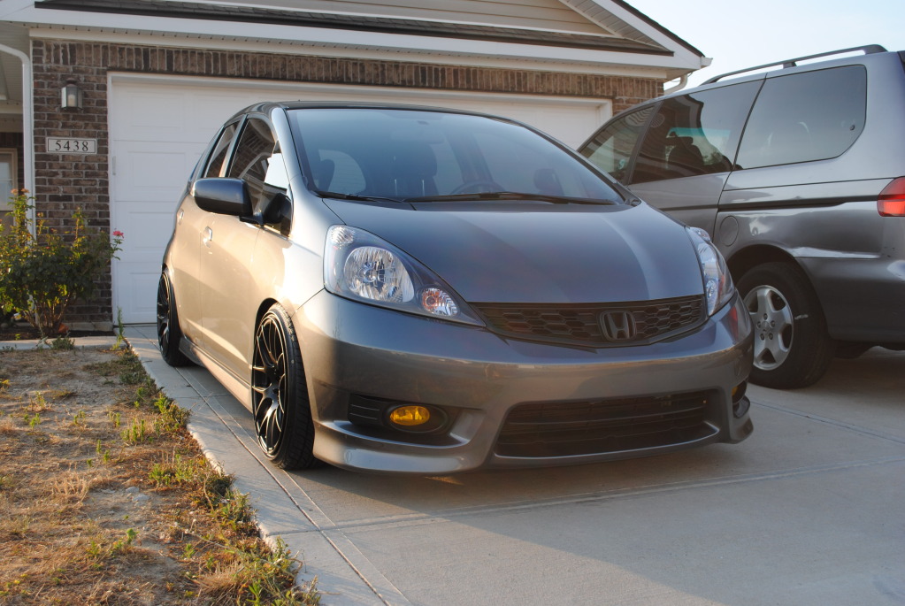

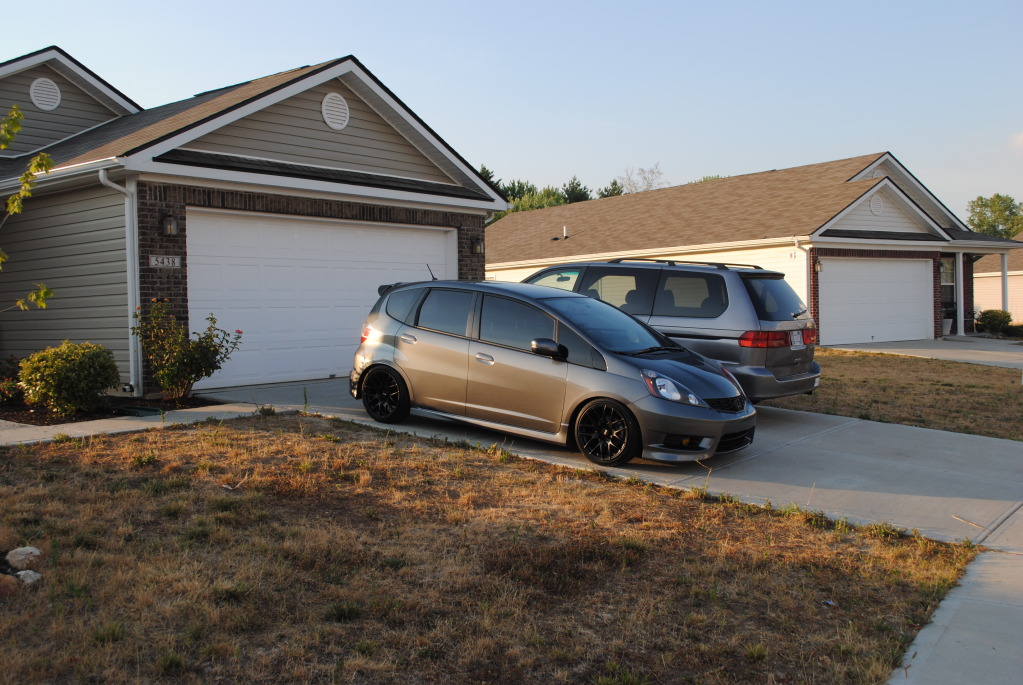

This is the only setup I've seen that looks good at 16x8 et20. Keep in mind he's also running 205/40's so he sits lower than you would have to sit with 45's. IIRC he's on BuddyClub's with one perch removed all around.

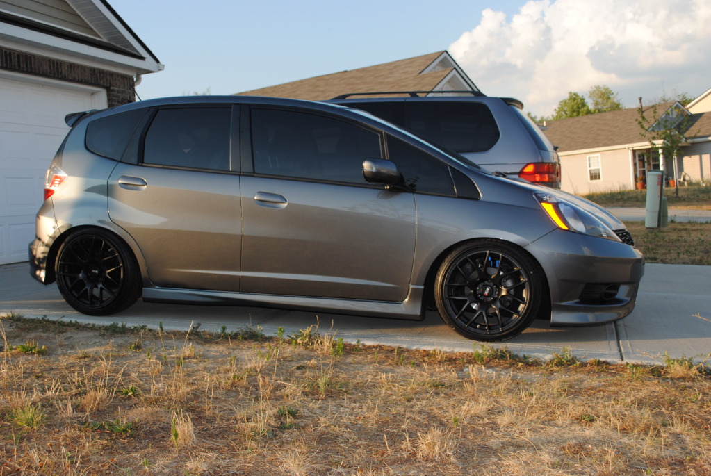

17x8.25 +20. Pulled fenders, 205/40/17 falkens

Ps:: still looking to go down a good 1/2" to 1"
