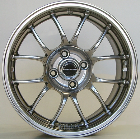

I've done a lot of research and I really like this wheel for my 2012 Sport.
I'm lowered on Swifts and plan to run either a 195/50 or 205/50 tire.
I know 15's are not that popular on the GE but I like the look myself.I'm aware of the semi aggressive offset compared to stock +53 but I think I will be ok with the mild drop on Swifts.
If anyone has experience with this exact combo on a GE 15x7 +36 with 195/50 or 205/50 and springs like Swifts or Progress chime in and let me no if you had any rubbing without fender mods.
thanks in advance

Go 15x7.5 so you are at the maximum Street Touring FWD wheel width if you ever end up running at a local SCCA AutoX event You can still run a 195-50R15 on a 7.5, I do.
Here is a good resource for comparing any wheel and tire combos you may want to run: Custom rims, wheel tire packages for your ride - RIMSnTIRES.com

@TPC thanks for the good info I will keep this in mind when I order my wheels.
The main reason I'm being conservative is my concern of rubbing.
is there much stretch with a 195 on a 15x7.5 wheel ? I do have the option of sizes 7,7.5,and even 8 but I will choose between 7 or 7.5
I love the look of 205/50/15 on 15x7 but I will stick with 195's if it will not rub given the +36 offset

Honestly it depends on your 195.
For example in the following pic the first one is a 205/50-15 Dunlops Z II on 6.5 wheel vs 195/50-15 Toyo R1R's on 7.5, vs 205/50-15 Dunlops Z II II on 7.5...
I LOVE my Toyo's But they are a soft competition tire and get eaten up a bit if you were to daily them.

you're the man!!! I may just go with the 15x7.5/195-50-15 combo
I'll run a sticky summer tire but not to soft of a compound as this is my DD
I knew you would have the answer to all my ?

Post some pictures when you get the wheels. The 15x7.5 are only 11.6lbs and the offset is 42.
15x7.5
+42 offset
11.5 lbs
4x100
Low pressure cast monoblock construction
T6 heat treated
67.1mm center bore
Double valve design
JWL approved
Silver painted, durable clear coated finish
Cap included
Valves not included
Fits 195/50 , 205/50 , 215/45 , 225/45 , 225/50 tires
Brian's Application Notes: This is the wheel all the FAST ST and STS class autocross competitors will be running this year....can't beat the price or low weight. For STS most will mount with 205/50/15 Dunlop Star Spec (which we don't carry) or 205/50/15 or 225/45/15 Toyo R1R (which we do carry). Does NOT fit our big brake kits but does fit FACTORY SPORT Brakes.

My 195 Azenis stretched a little on 7.5"... that was 60 sidewall tho haha
I'm in for pictures of these 15" 6ULs on GE. I mainly want to see what ends up having to be modded on fenders. Would run with 195/55 w/ swifts or there's going to be a ton of wheel gap, unless you don't mind it.

I'm running 15x7" +25 Kosei K1's with 205/50/15, lowered on Eibach Pro Kit springs on my GE8. No rubbing issues at any time on any type of road surface.

I run this wheel on my gd3. Its 15x8 with 225 45 15. Running hankook rs3 now but will be getting nt01. And when the nt01 wear out ill be getting hoosiers r6.
In a year when the car is all ready for honda challenge ill be running the toyo ra1.
This is a good wheel. Just make sure u check the torque of the lug nuts for the first little bit. I almost lost a wheel at chuckwalla. Good thing for extended studs.

I think the 15x7.5 will be the ticket with the better for me +42 offset and I can still choose between a 195/50 or 205 tire.
I know I will have some major gap with my Swifts but I'm ok with that and I could always go with coils if I want to get lower.
I see the hot set up with the miata guys is the combo mentioned above 15x8 with 225/45/15 but thats for the track
It's going to be a while before I can get my wheels (broke as a joke) but at least I have finally found a wheel that I really like at a great price
15x7 $129/15x7.5 $149 you cant beat that price for a light wheel
I'll be sure to post pics and related info when I get my wheels.

i did have to roll the inner lip on my fenders and also i am running -2.6 camber up front. im on ksport coilovers.
