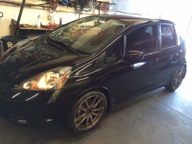

Old Aug 20, 2014 | 08:39 PM
FIT-tles Worth's Avatar
Joined: Apr 2011
Posts: 247
From: Miami, FL
Which wheels? Pics?
Old Aug 20, 2014 | 09:06 PM
BlueShell's Avatar
Posts: 83
From: Gardena, CA US
Originally Posted by FIT-tles Worth
Which wheels? Pics?
Not a good pic but here it is
