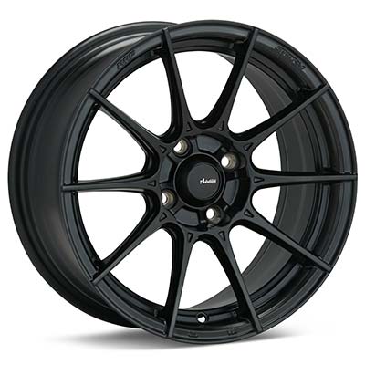

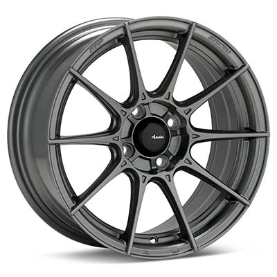

I guess I am pretty settled on the Advantis with 4Xs now, just need to decide on the matte gray vs black painted wheels. I am leaning towards the black because I have never had black rims and always wanted some. I rolled on Enkei 17's for YEARS with my 2003 Civic when I was in college.
I wish they were in stock not a 5 week wait.
