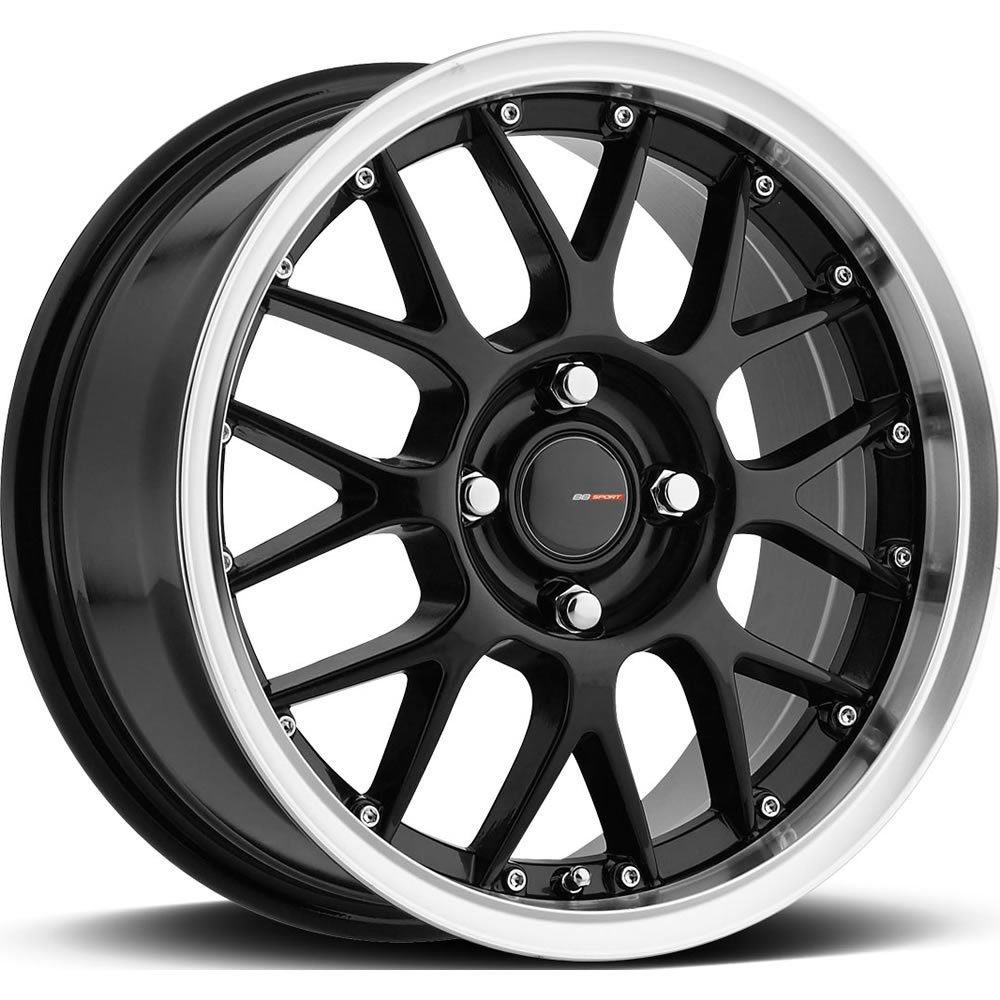

Found these on eBay for my JDM GE6.
15x7 Black Machined Big Bang BSP72 Wheels 4x100 4x4.5 +40
Anyone have a set or with experience in the specs to say if I will have any issues with fitment if I purchase? Also, what would be the optimum size tire for this setup...a 60 series or 55?

I have a 15x7 +35 and 195/55 tire with no rubbing issues. So you shouldnt have any issues with that at all.
Im also on coilovers.

Great response, thanks for your insight into the wheel size. I was considering 16" since the oem sport wheels come 16", correct me if I am wrong.
What tire size are you running with the 15x7 FamilyWagon? Roads here fall into disrepair so I dont want a thin sidewall tire for ride comfort and durability.

195/55
You can go with a 205/50r16
