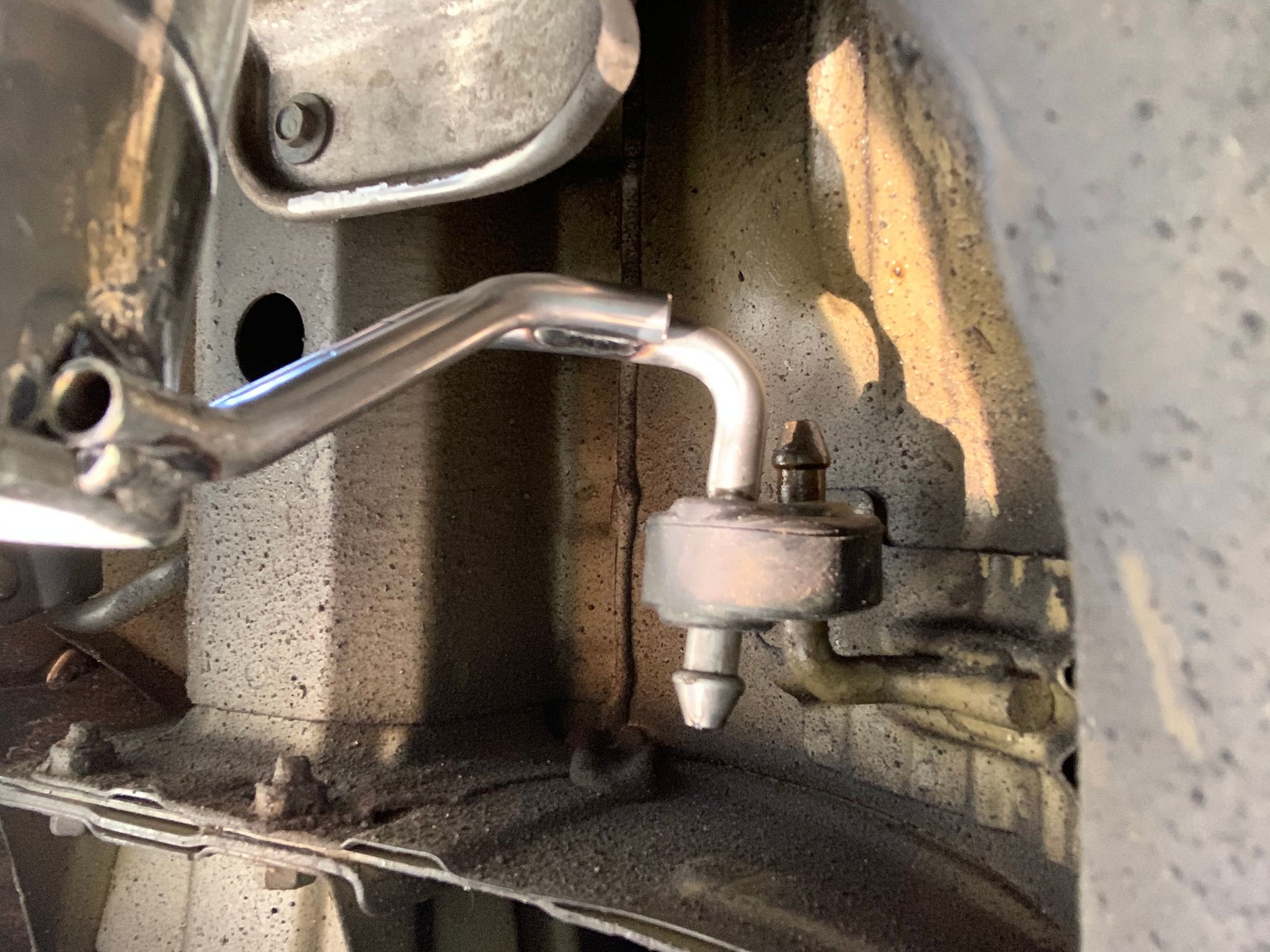

Any way I could bother you for a pic of the exhaust hangers (the rubber pieces)
I think the mounting points are the same, I just need one rubber hanger from a 2018+ LX/EX/etc
Thanks again!

Old Aug 8, 2020 | 06:23 PM

I think i can get the exhaust more centered if I use the LX/EX/etc drivers side rubber hanger.
Will order one and report back

https://www.hondapartsnow.com/genuin...5-tf0-003.html This is the other hanger. Couldn’t get a better angle with the iPad
edit: to answer your question about the nuts. Yes they were, the only difference is the hanger and the actual exhaust lip.
