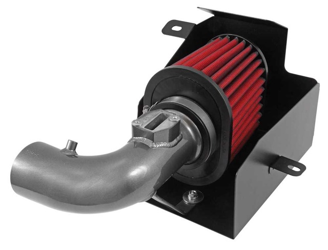

Finally something came out for the car lol.
21-748C - AEM , AEM Cold Air Intake System Factory Direct

I can't see how that is better than OE. It's possible it breaths better, I'd guess it draws hotter air.

I don't really see this as having any real benefit, especially on a naturally aspirated car. It's not really a "cold air" intake either haha.
The intake looks like it has a little bit of heat shielding, but it's still sucking in warmer, less dense air from the engine bay. This is versus the stock airbox which receives cooler, denser air directly from the intake tubing. The purpose of an upgraded intake is usually to allow more air to get into the engine, but when the cooler denser air expands in the hot engine this ends up amounting to "more" than you'd get with an open intake like that.
It's also sucking in relatively "motionless" air from the engine bay. Yes, I can see the stock airbox tubing is still there with this intake, allowing moving air to get into the bay as you drive, but for the most part the stock airbox is a closed system and as the car travels forward, air gets pushed up and in through the grille.
All of this adds up to faster-flowing, cooler, denser air getting pushed into the filter, versus hotter denser air getting sucked into the intake, which (in my opinion) makes an open cone intake like that relatively useless in applications like the Fit's engine, except maybe at high speeds (to push the most cold air possible into the engine bay) and high engine speeds. A better application for that type of intake would be a higher output forced induction motor.
Unless of course you're just doing it for the sound

It's pointed in the completely wrong direction. I agree, this is a hot air intake.

Usually I totally trust AEM with their designs and numbers but this one makes no sense to me at all. It's pointing backwards in the back of the engine bay ! I have trouble believing the 4HP and torque gain.
I had an AEM cold air in my previous car but I'll pass on this one. Come on K&N, give us something better !

agreed... its facing the wrong way...
the problem is that our engine layout does not allow for an intake to face the other direction...
if they can find a way to route the stock air box tubing to get closer to the filter, that may help.

I personally think it looks lousy. Even if it was sideways or facing forward, it's still way in the back where only hot or warm air exists. I'm really surprised it has the AEM name on it.
Look at the PRM intake design for example. I don't know about the power gain of that design but it makes much more sense to me. I don't like the fact that it seems to draw air from the front part of a tube instead of a bigger conical surface but at least the design seems more logical. I wonder if somebody could modify the stock Honda inlet. At least that part is drawing cold air.

A little creativity goes a long way. Wait until you see Weapon R's design and you'll see what I mean. Even still, it'll still be a hot air intake. You'll see!

im not saying anyone is knocking the intake but this word cold keeps getting thrown in there where would this cold air come from im i live in florida and temps are between 80's and almost 100. its always gonna be hot air going into it no matter if its in the back front or sideways.
Cold air just refers to drawing in outside air rather than warm/hot engine bay temperatures. If you are in Africa and the outside temperature is 110F, a cold air intake would pull in intake air temps of 110F or somewhere close to that. While a warm/hot air intake could be pulling in 20F+ (Upwards to even 60F+) higher temperatures than the outside air temperature.

I not going to go as far as saying the test results were manipulated, but they are not realistic gains in many scenarios. I saw the ambient test temps were below 50 degrees; I did not see mention of engine temps, so heat soak can have an effect on the results. Also, what was the condition of the control intake? Was it new and clean OEM? Dirty? Other?
I'm not sold on the idea there will be a 4hp gain in, say, 100 degree Florida.
Check this link for more perspective on "cold air" intakes:
K&N Air Filter Review - Debunking the Myths (and why OEM is better)
