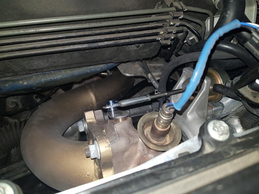

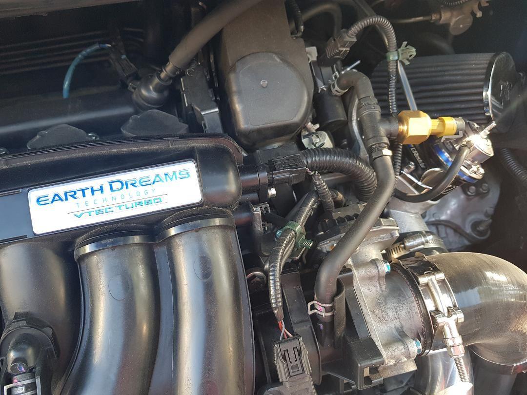

Huge congrats to my good friend overseas. Feel free to chime in on your build if you see this. I'm beyond happy to see what you have done and am behind you 100%. Good stuff! Hoping to see you get it all tuned and ready.
Otherwise, this will just be a mystery to you folks. If he decides he wants me to delete this post.....done deal. I won't give out too much more info. Just letting folks know what's possible and what is being done out there. It's running 5psi without issue. And was done by someone in their garage.

Hard to tell from the pics, but a couple questions:
Looks like he's running an intercooler too?
What kind of turbo did he use?
Custom turbo manifold?
What kind of engine management?
Dyno numbers?
Yes!
He'll have to say.
Yes!
Ktuner
Dyno numbers?
Nope!
Answers above in red.
yes.... an ebay turbo
2016 civic turbo.... just ported it a little bit, with a custom downpipe and custom intake pipes on turbo side
I don't know what do you call a turbo manifold... Is it the exhaust manifold from engine???? Because if it is then it is only a matter of drilling the bolt pattern from the fit into the exhaust side of the turbo to make it bolt on
Ktuner, but still needs to keep figuring out a better tune
Dyno numbers?
I don't know but on quarter mile I'm head to head to a stock 2016 civic turbo sedan..
It is really fund to drive

Did you by any chance take pictures as you were putting this together? I don't know if I'm capable of pulling this off myself, but pictures of the build might save a bunch of stupid questions like where did you put the MAF, did you have to get a custom fitting or reuse a stock part to mount it, where are the oil lines routed to and from the turbo, that kind of thing.
Either way, this is fantastic and inspiring.

Yes I stopped by looking for options on upgrading pistons and connecting rods and saw this post from our old good friend Kevin... Right now I'm planning on running a set of K1 forged rods for the L15a (because this seems to me the weakest link on the current engine) and pistons from the L15b7 to lower compression ratio and ad strength... What do you guys think???
I did not have pictures of the hole process, just the ones Kevin uploaded, but when I take the engine out to upgrade pistons and rods maybe I take a couple more... The problem is that must of the work is done on the back side of the car and there is no much room for a camera to capture a good angle to understand things, but with the engine out all would be more clear

As long as I'm asking questions, curious how/where you mounted the MAF, and how you ran the oil lines to the turbo?

the maf is right before the turbo and after the air filter, I used a cheap civic r18 pipe for the base of the sensor and chopped it to fit my needs
