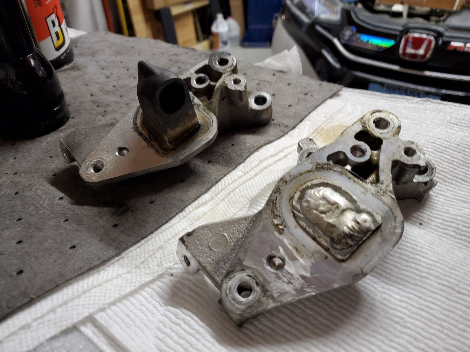

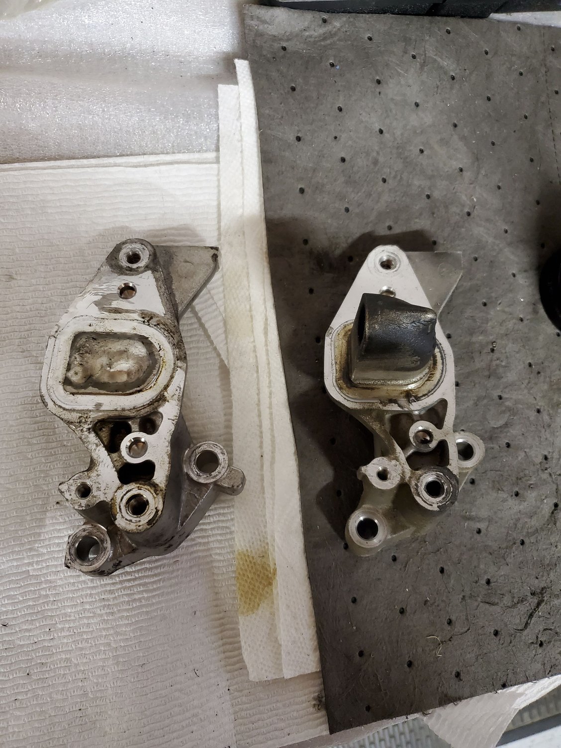

Gonna bring this topic back to life.... Has any GK owner fiddled around with the shark fin thingy comming from the EGR ..... ITS the only obstruction left on my set up ..... and im willing to block it if serves the purpose of removing it from the already small intake....

Intake shark fin
I cut mine off and it felt better immediately. I got a low egr code and you can tune that out on ktuner. I don't need mine. I can send it to you for $20 plus shipping already welded. The RZcrew intake comes with a block off so I'm using that now

Hey peeps fabricated two block off plates using the modded EGR spacer (as named on the honda parts pages) Z06FIT sent me as a mold...
These are rough cuts used for fitment... They worked likea charm... Obviously the low flow egr code came up but it was disabled through the KTuner, it feels running more loosely and more responsive... No dyno tune yet... Updates as soon as I can dyno it!
Dude you're always coming up with these really cool elegant solutions. Nice block off plates, no need to cut/weld. Super clean. Well done dude !
